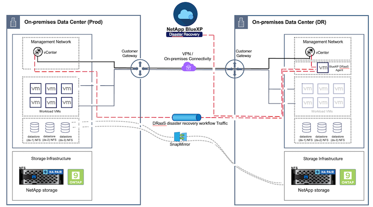

This section of the document describes the configuration of BlueXP DRaaS to set up disaster recovery for on-premises VMware VMs to another designated site. As part of this setup, the BlueXP account, BlueXP connector, the ONTAP arrays added within BlueXP workspace which is needed to enable communication from VMware vCenter to the ONTAP storage. In addition, this document details how to configure replication between sites and how to setup and test a recovery plan. The last section has instructions for performing a full site failover and how to failback when the primary site is recovered and bought online.
Utilizing the BlueXP disaster recovery service, integrated into the NetApp BlueXP console, companies can easily discover their on-premises VMware vCenters and ONTAP storage. Organizations can then create resource groupings, create a disaster recovery plan, associate it with resource groups, and test or execute failover and failback. SnapMirror provides storage-level block replication to keep the two sites up to date with incremental changes, resulting in a Recovery Point Objective (RPO) of up to 5 minutes. Additionally, it is possible to simulate disaster recovery procedures without affecting production or incurring additional storage costs.
BlueXP disaster recovery leverages ONTAP's FlexClone technology to create a space-efficient copy of the NFS datastore from the last replicated Snapshot on the disaster recovery site. After completing the disaster recovery test, customers can easily delete the test environment without impacting actual replicated production resources. In case of an actual failover, the BlueXP disaster recovery service orchestrates all the necessary steps to automatically bring up the protected virtual machines on the designated disaster recovery site with just a few clicks. The service will also reverse the SnapMirror relationship to the primary site and replicate any changes from the secondary to the primary for a failback operation, when needed. All these capabilities come at a fraction of the cost compared to other well-known alternatives.

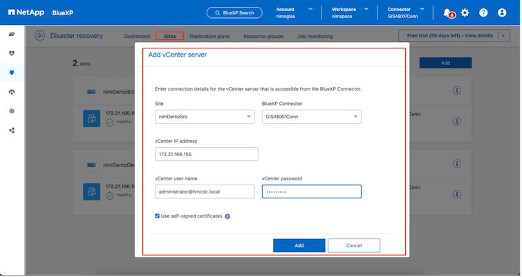

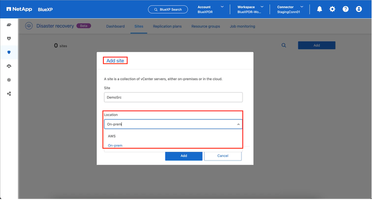

The first step in preparing for disaster recovery is to discover and add the on-premises vCenter and storage resources to BlueXP disaster recovery.
Open BlueXP console and select Protection > Disaster Recovery from left navigation. Select Discover vCenter servers or use top menu, Select Sites > Add > Add vCenter.
Add the following platforms:
Source. On-premises vCenter.
Destination. VMC SDDC vCenter.
Once the vCenters are added, automated discovery is triggered.

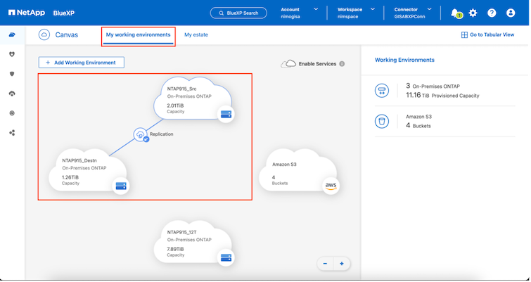

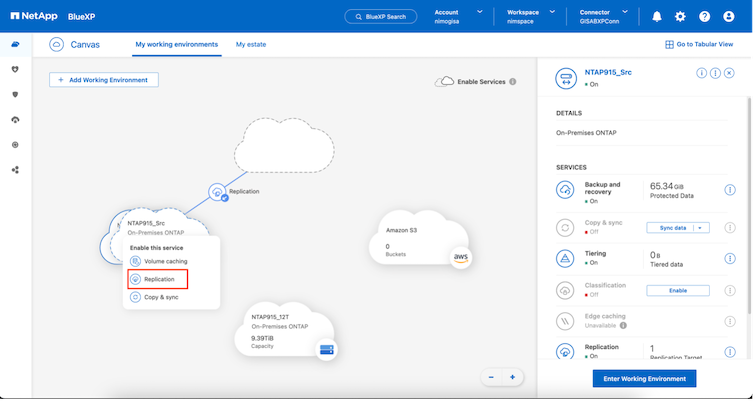

Configuring Storage replication between source site array and destination site array
SnapMirror provides data replication in a NetApp environment. Built on NetApp Snapshot technology, SnapMirror replication is extremely efficient because it replicates only the blocks that have been changed or added since the previous update. SnapMirror is easily configured by using either NetApp OnCommand System Manager or the ONTAP CLI. BlueXP DRaaS also creates the SnapMirror relationship provided cluster and SVM peering is configured beforehand.
For cases in which the primary storage is not completely lost, SnapMirror provides an efficient means of resynchronizing the primary and DR sites. SnapMirror can resynchronize the two sites, transferring only changed or new data back to the primary site from the DR site by simply reversing the SnapMirror relationships. This means replication plans in BlueXP DRaaS can be resynchronized in either direction after a failover without recopying the entire volume. If a relationship is resynchronized in the reverse direction, only new data that was written since the last successful synchronization of the Snapshot copy is sent back to the destination.
If SnapMirror relationship is already configured for the volume via CLI or System Manager, BlueXP DRaaS picks up the relationship and continues with the rest of the workflow operations. |
How to set it up for VMware Disaster Recovery
The process to create SnapMirror replication remains the same for any given application. The process can be manual or automated. The easiest way is to leverage BlueXP to configure SnapMirror replication by using simple drag & drop of the source ONTAP system in the environment onto the destination to trigger the wizard that guides through the rest of the process.
BlueXP DRaaS can also automate the same provided the following two criteria's are met:
Source and destination clusters have a peer relationship.
Source SVM and destination SVM have a peer relationship.
If SnapMirror relationship is already configured for the volume via CLI, BlueXP DRaaS picks up the relationship and continues with the rest of the workflow operations. |

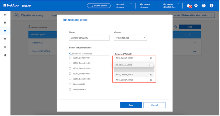

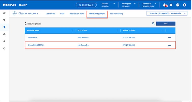

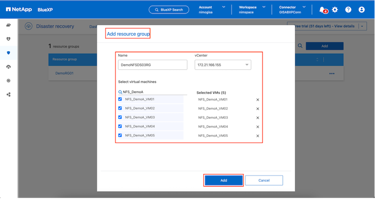

After the sites have been added, VMs can be grouped into resource groups. BlueXP disaster recovery resource groups allow you to group a set of dependent VMs into logical groups that contain their boot orders and boot delays that can be executed upon recovery. To start creating resource groups, navigate to Resource Groups and click Create New Resource Group.
The resource group can also be created while creating a replication plan. |
The boot order of the VMs can be defined or modified during the creation of resource groups by using simple drag and drop mechanism.

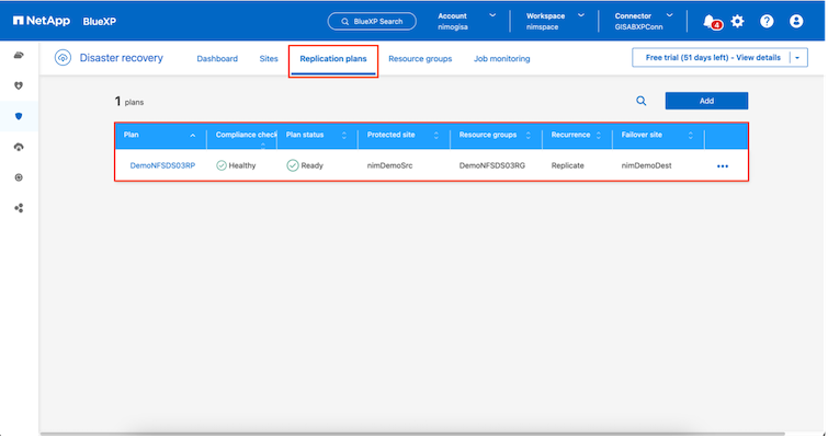

Once the resource groups are created, the next step is to create the execution blueprint or a plan to recover virtual machines and applications in the event of a disaster. As mentioned in the prerequisites, SnapMirror replication can be configured beforehand or DRaaS can configure it using the RPO and retention count specified during creation of the replication plan.

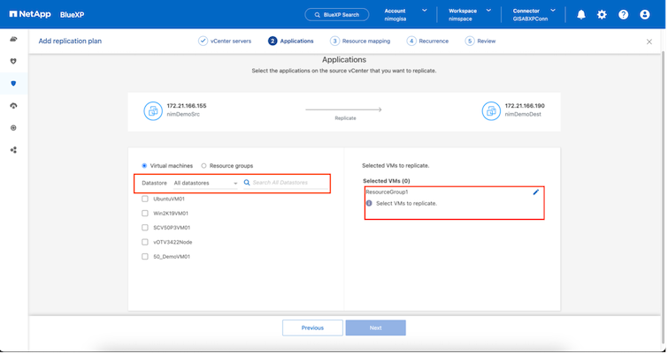

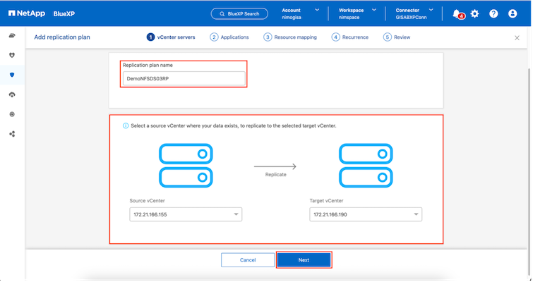

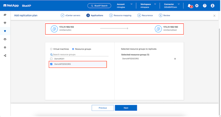

Configure the replication plan by selecting the source and destination vCenter platforms from the drop down and pick the resource groups to be included in the plan, along with the grouping of how applications should be restored and powered on and mapping of clusters and networks. To define the recovery plan, navigate to the Replication Plan tab and click Add Plan.
First, select the source vCenter and then select the destination vCenter.
The next step is to select existing resource groups. If no resource groups created, then the wizard helps to group the required virtual machines (basically create functional resource groups) based on the recovery objectives. This also helps define the operation sequence of how application virtual machines should be restored.
Resource group allows to set boot order using the drag and drop functionality. It can be used to easily modify the order in which the VMs would be powered on during the recovery process. |
Each virtual machine within a resource group is started in sequence based on the order. Two resource groups are started in parallel. |
The below screenshot shows the option to filter virtual machines or specific datastores based on organizational requirements if resource groups are not created beforehand.

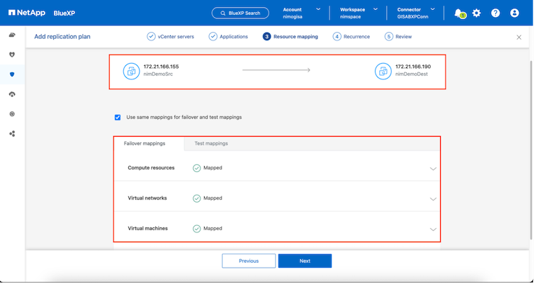

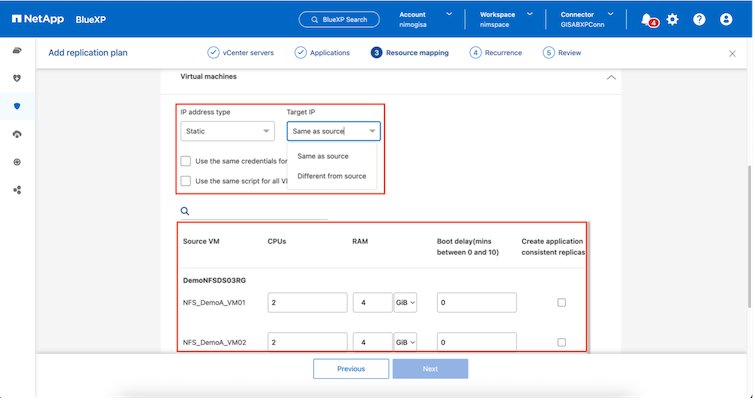

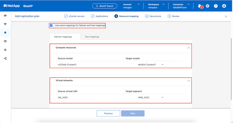

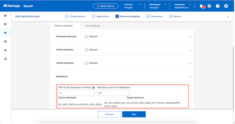

Once the resource groups are selected, create the failover mappings. In this step, specify how the resources from the source environment maps to the destination. This includes compute resources, virtual networks. IP customization, pre- and post-scripts, boot delays, application consistency and so on. For detailed information, refer to Create a replication plan.
By default, same mapping parameters are used for both test and failover operations. To set different mappings for test environment, select the Test mapping option after unchecking the checkbox as shown below: |
Once the resource mapping is complete, click Next.

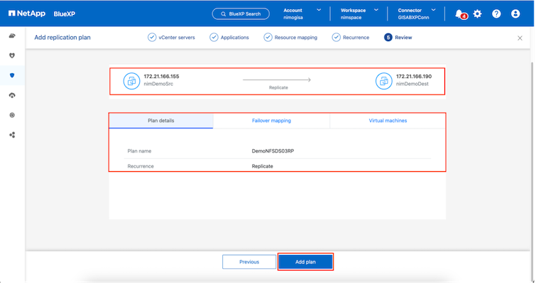

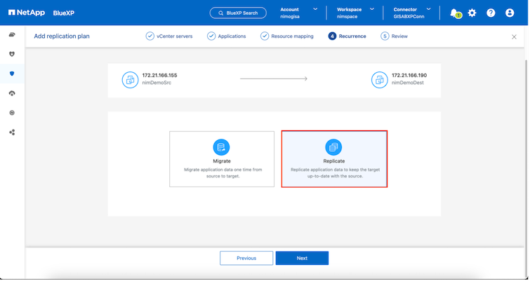

Select the recurrence type. In simple words, select Migrate (one time migration using failover) or recurring continuous replication option. In this walkthrough, Replicate option is selected.
Once done, review the created mappings and then click on Add plan.

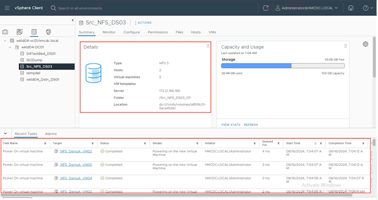

Test failover

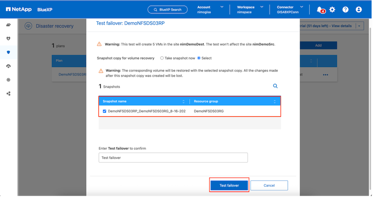

Test failover in BlueXP DRaaS is an operational procedure that allows VMware administrators to fully validate their recovery plans without disrupting their production environments.
BlueXP DRaaS incorporates the ability to select the snapshot as an optional capability in the test failover operation. This capability allows the VMware administrator to verify that any changes that were recently made in the environment are replicated to the destination site and thus are present during the test. Such changes include patches to the VM guest operating system
When the VMware administrator runs a test failover operation, BlueXP DRaaS automates the following tasks:
Triggering SnapMirror relationships to update storage at the destination site with any recent changes that were made at the production site.
Creating NetApp FlexClone volumes of the FlexVol volumes on the DR storage array.

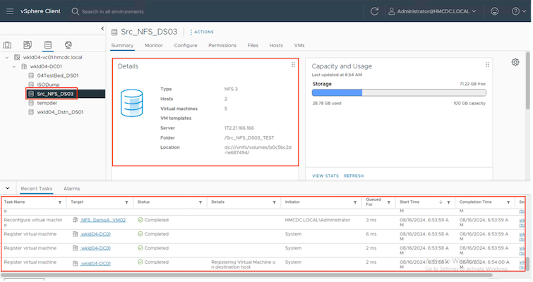

Connecting the NFS datastores in the FlexClone volumes to the ESXi hosts at the DR site.
Connecting the VM network adapters to the test network specified during the mapping.
Reconfiguring the VM guest operating system network settings as defined for the network at the DR site.
Executing any custom commands that have been stored in the replication plan.
Powering on the VMs in the order that is defined in the replication plan.

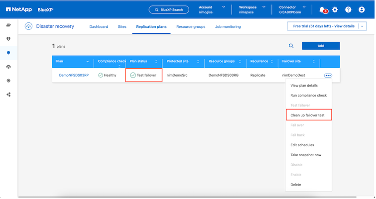

Cleanup failover test Operation
The cleanup failover test operation occurs after the replication plan test has been completed and the VMware administrator responds to the cleanup prompt.
This action will reset the virtual machines (VMs) and the status of the replication plan to the ready state.
When the VMware administrator performs a recovery operation, BlueXP DRaaS completes the following process:
It powers off each recovered VM in the FlexClone copy that was used for testing.
It deletes the FlexClone volume that was used to present the recovered VMs during the test.

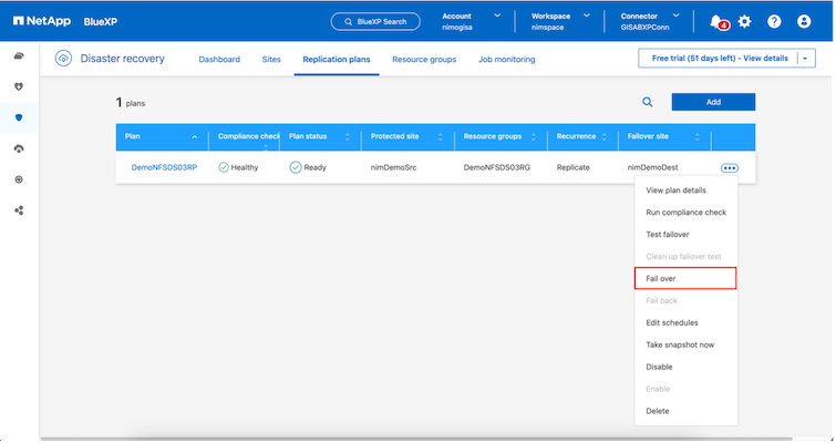

BlueXP DRaaS has two methods for performing a real failover: planned migration and fail over. The first method, planned migration, incorporates VM shutdown and storage replication synchronization into the process to recover or effectively move the VMs to the destination site. Planned migration requires access to the source site. The second method, failover, is an planned/unplanned failover in which the VMs are recovered at the destination site from the last storage replication interval that was able to complete. Depending on the RPO that was designed into the solution, some amount of data loss can be expected in the DR scenario.
When the VMware administrator performs a failover operation, BlueXP DRaaS automates the following tasks:
Break and fail over the NetApp SnapMirror relationships.
Connect the replicated NFS datastores to the ESXi hosts at the DR site.
Connect the VM network adapters to the appropriate destination site network.
Reconfigure the VM guest operating system network settings as defined for the network at the destination site.
Execute any custom commands (if any) that have been stored in the replication plan.
Power on the VMs in the order that was defined in the replication plan.

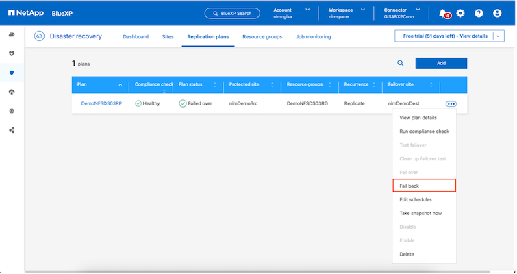

Failback
A failback is an optional procedure that restores the original configuration of the source and destination sites after a recovery.
VMware administrators can configure and run a failback procedure when they are ready to restore services to the original source site.
NOTE: BlueXP DRaaS replicates (resyncs) any changes back to the original source virtual machine before reversing the replication direction. This process starts from a relationship that has completed failing over to a target and involves the following steps:
Power off and unregister the virtual machines and volumes on the destination site are unmounted.
Break the SnapMirror relationship on the original source is broken to make it read/write.
Resynchronize the SnapMirror relationship to reverse the replication.
Mount the volume on the source, power on and register the source virtual machines.

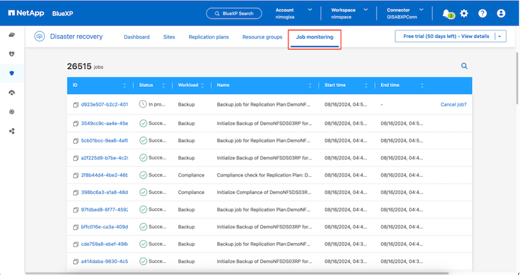

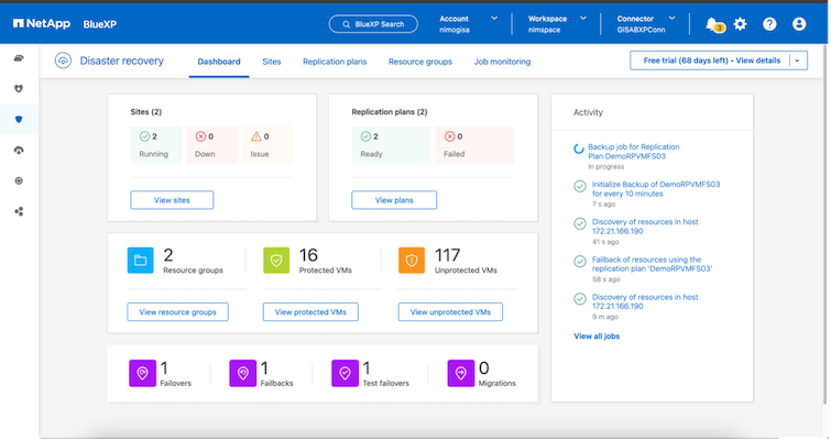

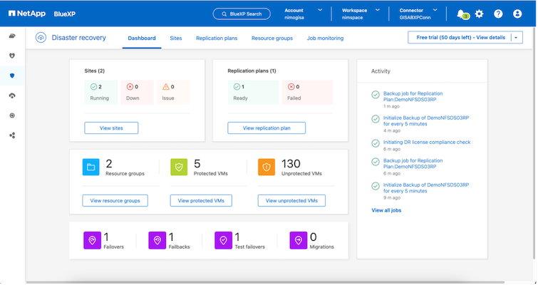

Monitoring and Dashboard
From BlueXP or the ONTAP CLI, you can monitor the replication health status for the appropriate datastore volumes, and the status of a failover or test failover can be tracked via Job Monitoring.
If a job is currently in progress or queued, and you wish to stop it, there is an option to cancel it. |
With the BlueXP disaster recovery dashboard, confidently evaluate the status of disaster recovery sites and replication plans. This enables administrators to swiftly identify healthy, disconnected, or degraded sites and plans.
This provides a powerful solution to handle a tailored and customized disaster recovery plan. Failover can be done as planned failover or failover with a click of a button when disaster occurs and decision is made to activate the DR site.
