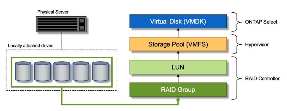

ONTAP Select virtual disks
At its core, ONTAP Select presents ONTAP with a set of virtual disks provisioned from one or more storage pools. ONTAP is presented with a set of virtual disks that it treats as physical, and the remaining portion of the storage stack is abstracted by the hypervisor. The following figure shows this relationship in more detail, highlighting the relationship between the physical RAID controller, the hypervisor, and the ONTAP Select VM.
  • RAID group and LUN configuration occur from within the server’s RAID controller software. This configuration is not required when using VSAN or external arrays.
  • Storage pool configuration occurs from within the hypervisor.
  • Virtual disks are created and owned by individual VMs; in this example, by ONTAP Select.
Virtual disk to physical disk mapping
