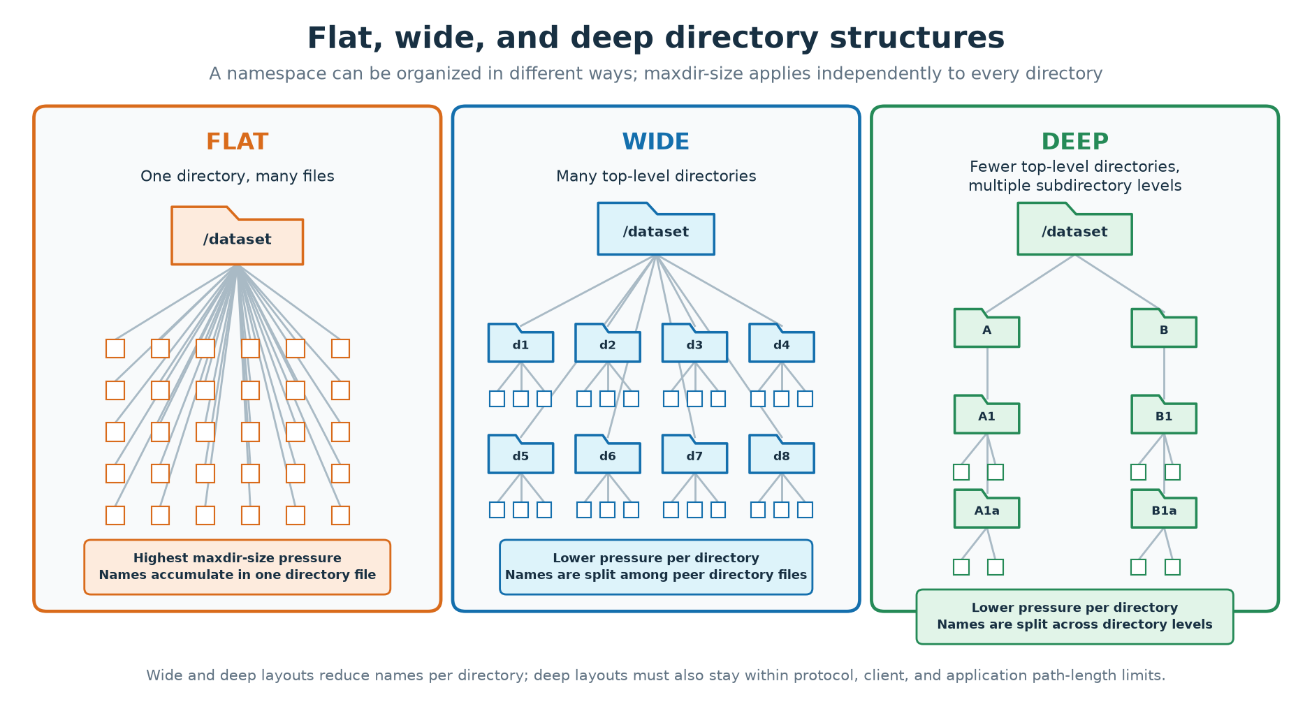

There are three common namespace layouts.
  • Flat: one or a few directories contain many files at the same level.
  • Wide: many top-level directories divide the files.
  • Deep: fewer top-level directories lead to multiple levels of subdirectories.
Diagram comparing a flat namespace with many files in one directory
When possible, avoid placing millions of names at one flat directory level if the application can use a wide or deep hierarchy. Flat layouts concentrate memory and CPU work and can increase latency during mass GETATTR, READDIR, lookup, and delete operations. In a FlexGroup volume, a large flat directory can also produce more remote entries, causing its directory file to approach maxdir-size sooner than the same visible name count in a FlexVol.
FlexGroup volumes generally work best with many smaller directories rather than one large flat directory. Directories below about 2 MiB stay on the simple scan path. Beginning with ONTAP 9.2, larger directories are indexed automatically, which helps targeted lookups. Indexing does not make a very large directory equivalent to a sharded hierarchy: enumeration, wildcard scans, and single-directory create serialization still apply. ONTAP can place FlexGroup child directories remotely while favoring file locality to the parent directory, which reduces remote latency for those files.
Distributing files across a hierarchy means using more directories with fewer files in each directory.
Common sharding keys include:
  • A hash prefix
  • Customer, project, or tenant
  • Date or time window
  • Dataset, job, or workflow stage
  • Object type or lifecycle state
Choose enough shards to keep directory operations manageable, but do not create so many nearly empty directories that directory count itself becomes excessive. A deterministic scheme makes placement predictable and allows clients to locate files without scanning every shard.
Wide and deep layouts can both work. Keep complete path lengths within the limits of the NAS protocol, client operating system, and application. If a flat layout is unavoidable, monitor the largest directory file's current size and maxdir-size headroom as described in View maxdir-size and current directory size, and validate whether a controlled increase is appropriate.
