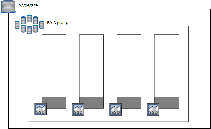

An aggregate that has the Elastic Volumes feature enabled is comprised of one or two RAID groups. Each RAID group has four identical disks that have the same capacity. Here's an example of a 10 TiB aggregate that has four disks that are 2.5 TiB each:
A conceptual image that shows an aggregate and a RAID group that is comprised of four disks of equal size.
When the Console creates an aggregate, it starts with one RAID group. If additional capacity is needed, it grows the aggregate by increasing the capacity of all disks in the RAID group by the same amount. The capacity increase is either a minimum of 256 GiB or 10% of the aggregate's size.

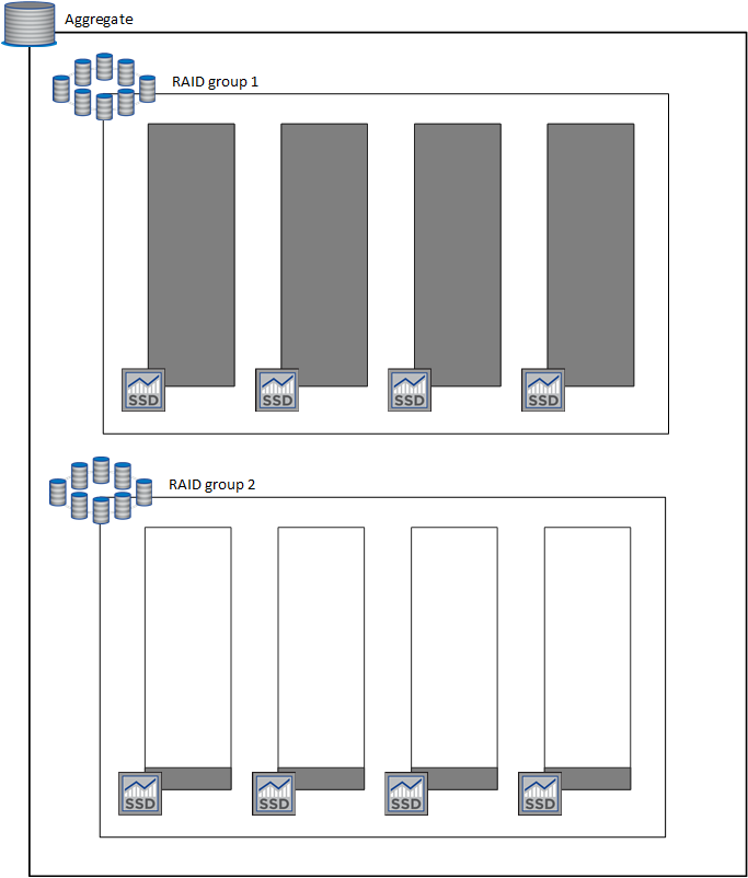

If an aggregate reaches 64 TiB (or 16 TiB on each disk), the Console creates a second RAID group for additional capacity. This second RAID group works just like the first one: it has four disks that have the exact same capacity and it can grow up to 64 TiB. That means an aggregate can have a maximum capacity of 128 TiB.
Here's an example of an aggregate with two RAID groups. The capacity limit has been reached on the first RAID group, while the disks in the second RAID group have plenty of free space.
A conceptual image that shows an aggregate and two RAID groups that are both comprised of four disks of equal size.

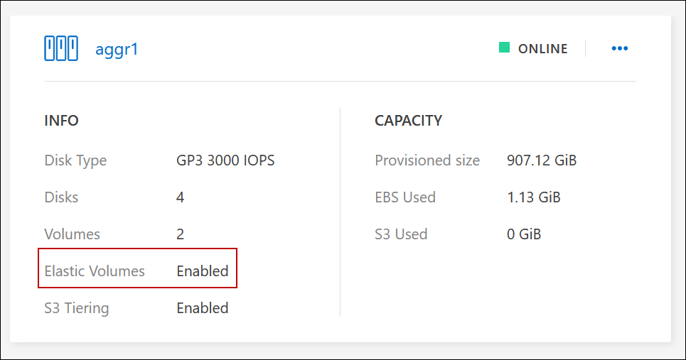

  • Identify aggregates that have Elastic Volumes enabled
    When you go to the Advanced Allocation page, you can identify whether the Elastic Volumes feature is enabled on an aggregate. In the following example, aggr1 has Elastic Volumes enabled.
    Screenshot that shows two aggregates where one has a field with the text Elastic Volumes Enabled.
