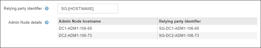

    3. In the Relying Party section, specify the Relying party identifier for StorageGRID. This value controls the name you use for each relying party trust in AD FS.
      • For example, if your grid has only one Admin Node and you don't anticipate adding more Admin Nodes in the future, enter SG or StorageGRID.
      • If your grid includes more than one Admin Node, include the string [HOSTNAME] in the identifier. For example, SG-[HOSTNAME]. This generates a table that shows the relying party identifier for each Admin Node in your system, based on the node's hostname.
        Single Sign-on
        Note You must create a relying party trust for each Admin Node in your StorageGRID system. Having a relying party trust for each Admin Node ensures that users can securely sign in to and out of any Admin Node.

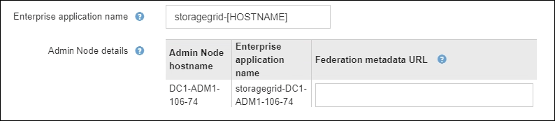

    2. In the Enterprise Application section, specify the Enterprise application name for StorageGRID. This value controls the name you use for each enterprise application in Azure AD.
      • If your grid includes more than one Admin Node, include the string [HOSTNAME] in the identifier. For example, SG-[HOSTNAME]. This generates a table that shows an enterprise application name for each Admin Node in your system, based on the node's hostname.
        Single Sign-on
        Note You must create an enterprise application for each Admin Node in your StorageGRID system. Having an enterprise application for each Admin Node ensures that users can securely sign in to and out of any Admin Node.

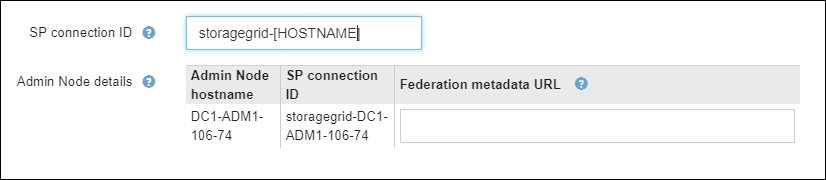

    2. In the Service Provider (SP) section, specify the SP connection ID for StorageGRID. This value controls the name you use for each SP connection in PingFederate.
      • If your grid includes more than one Admin Node, include the string [HOSTNAME] in the identifier. For example, SG-[HOSTNAME]. This generates a table that shows the SP connection ID for each Admin Node in your system, based on the node's hostname.
        Single Sign-on
        Note You must create an SP connection for each Admin Node in your StorageGRID system. Having an SP connection for each Admin Node ensures that users can securely sign in to and out of any Admin Node.
    3. Specify the federation metadata URL for each Admin Node in the Federation metadata URL field.
