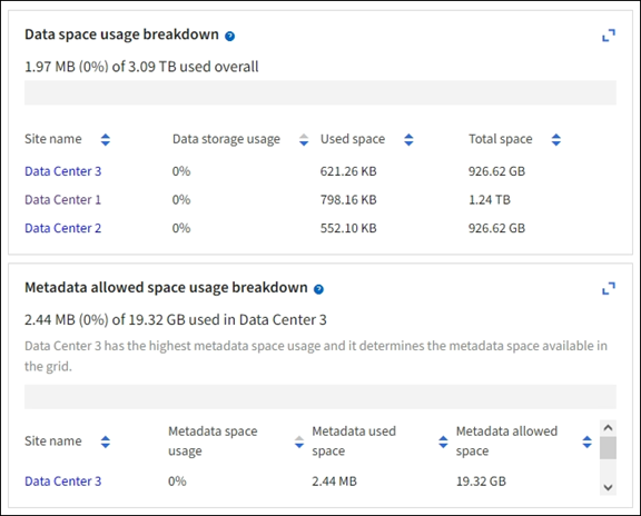

  1. Assess how much storage is available for the entire grid and for each data center.
    1. Select Dashboard > Overview.
    2. Note the values on the Data space usage breakdown and the Metadata allowed space usage breakdown cards. Each card lists a percentage of storage usage, the capacity of used space, and the total space available or allowed by site.
      Note The summary does not include archival media.
      Data and metadata space usage breakdown
