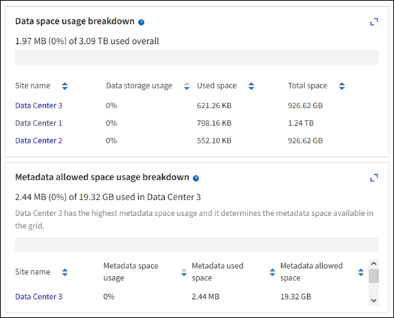

  1. Assess how much storage is available for the entire grid and for each data center.
    1. Select Dashboard > Overview.
    2. Note the values on the Data space usage breakdown and the Metadata allowed space usage breakdown cards. Each card lists a percentage of storage usage, the capacity of used space, and the total space available or allowed by site.
      Note The summary does not include archival media.
      Data and metadata space usage breakdown

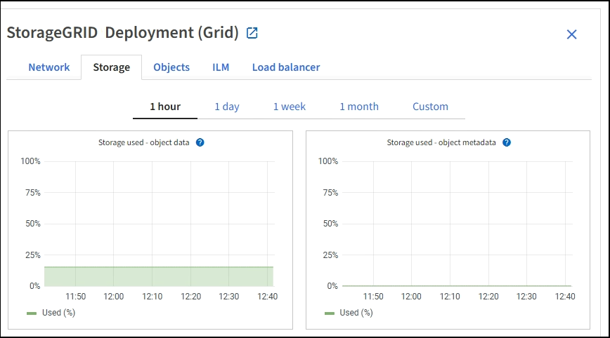

  2. Use the Nodes page for additional details on how much storage has been used and how much storage remains available on the grid for object data and object metadata.
    1. Select Nodes.
    2. Select grid > Storage.
      Nodes Deployment Storage tab
    3. Position your cursor over the Storage used - object data and the Storage used - object metadata charts to see how much object storage and object metadata storage is available for the entire grid, and how much has been used over time.
