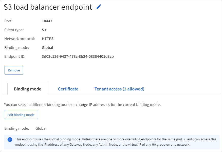

View and edit load balancer endpoints
You can view details for existing load balancer endpoints, including the certificate metadata for a secured endpoint. You can change certain settings for an endpoint.
  • To view basic information for all load balancer endpoints, review the tables on the Load balancer endpoints page.
  • To view all details about a specific endpoint, including certificate metadata, select the endpoint's name in the table. The information shown varies depending on the endpoint type and how it's configured.
    Load balancer endpoint details
  • To edit an endpoint, use the Actions menu on the Load balancer endpoints page.
    Note If you lose access to Grid Manager while editing the port of a management interface endpoint, update the URL and port to regain access.
    Tip After editing an endpoint, you might need to wait up to 15 minutes for your changes to be applied to all nodes.

    1. Select the endpoint name to display the details.
    2. Select the edit icon Edit icon.
    3. Enter the new name.
    4. Select Save.

    2. Select Edit binding mode.
    3. Update the binding mode as required.
    4. Select Save changes.
    Edit endpoint certificate
    1. Select the checkbox for the endpoint.
    2. Select Actions > Edit endpoint certificate.
    3. Upload or generate a new custom certificate or begin using the global S3 certificate, as required.
    2. Select the Certificate tab.
    3. Select Edit certificate.
    4. Upload or generate a new custom certificate or begin using the global S3 certificate, as required.
    5. Select Save changes.
    Edit tenant access
    2. Select Actions > Edit tenant access.
    3. Choose a different access option, select or remove tenants from the list, or do both.
    2. Select the Tenant access tab.
    3. Select Edit tenant access.
    4. Choose a different access option, select or remove tenants from the list, or do both.
