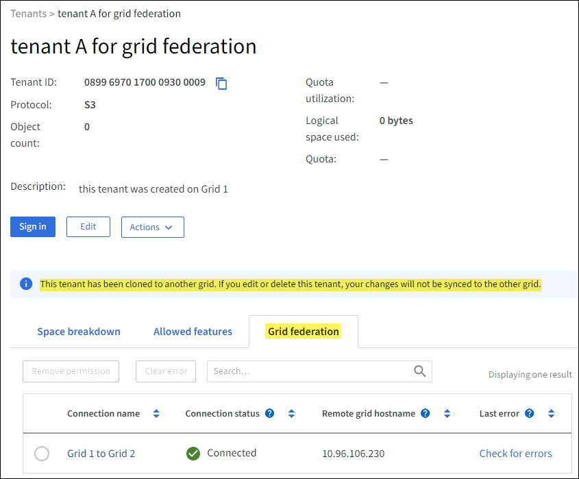

    If this is the source grid for the tenant (that is, if the tenant was created on this grid), a banner appears to remind you that the tenant was cloned to another grid. If you edit or delete this tenant, your changes will not be synced to the other grid.
    Grid federation tab from Tenant details page
  3. Optionally select the Grid federation tab to monitor the grid federation connection.
