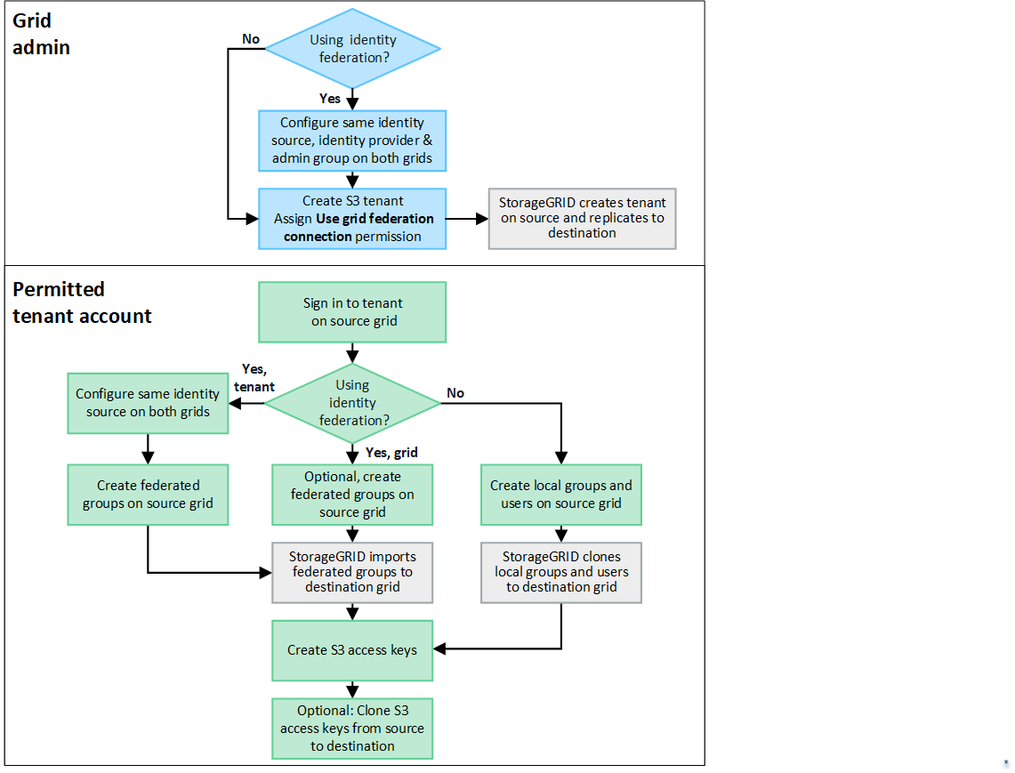

Workflow for account clone
The workflow diagram shows the steps that grid administrators and permitted tenants will perform to set up account clone. These steps are performed after the grid federation connection is configured.
workflow for account clone
Grid admin workflow
The steps that grid admins perform depend on whether the StorageGRID systems in the grid federation connection use single sign-on (SSO) or identity federation.

Permitted tenant account workflow
After a tenant with the Use grid federation connection permission is replicated to the destination grid, permitted tenant accounts can perform these steps to clone tenant groups, users, and S3 access keys.
Steps
  1. Sign in to the tenant account on the tenant's source grid.
  2. If permitted, configure identify federation on both the source and destination tenant accounts.
  3. Create groups and users on the source tenant.
    When new groups or users are created on the source tenant, StorageGRID automatically clones them to the destination tenant, but no cloning occurs from the destination back to the source.
  4. Create S3 access keys.
  5. Optionally, clone S3 access keys from the source tenant to the destination tenant.
For details about the permitted tenant account workflow and to learn how groups, users, and S3 access keys are cloned, see Clone tenant groups and users and Clone S3 access keys using the API.
