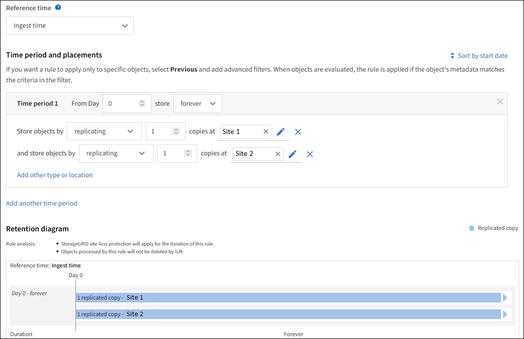

ILM rule 1 for example 1: Copy object data to two sites
This example ILM rule copies object data to storage pools in two sites.
Rule definition Example value
One-site storage pools
Two storage pools, each containing different sites, named Site 1 and Site 2.
Rule name
Two Copies Two Sites
Reference time
Ingest time
Placements
On Day 0 to forever, keep one replicated copy at Site 1 and one replicated copy at Site 2.
The Rule analysis section of the Retention diagram states:
  • StorageGRID site-loss protection will apply for the duration of this rule.
  • Objects processed by this rule will not be deleted by ILM.

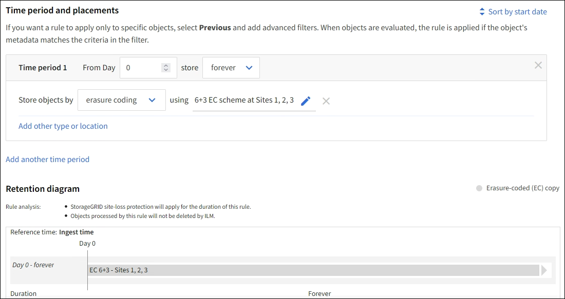

ILM rule 2 for example 1: Erasure-coding profile with bucket matching
This example ILM rule uses an erasure-coding profile and an S3 bucket to determine where and how long the object is stored.
Storage pool with multiple sites
  • One storage pool across three sites (Sites 1, 2, 3)
  • Use 6+3 erasure-coding scheme
Rule name
S3 Bucket finance-records
Reference time
Ingest time
Placements
For objects in the S3 bucket named finance-records, create one erasure-coded copy in the pool specified by the erasure-coding profile. Keep this copy forever.
ILM rule 2 for example 1: erasure-coding profile with bucket matching
