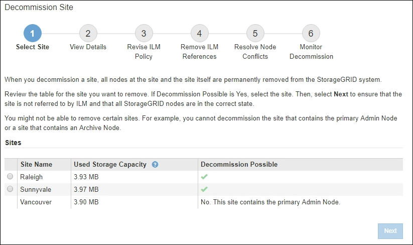

    Step 1 (Select Site) of the Decommission Site wizard appears. This step includes an alphabetic list of the sites in your StorageGRID system.
    Decommission Site Step 1 Select Site

    The example shows a StorageGRID system with three sites. The green check mark (Icon Alert Green check mark) for the Raleigh and Sunnyvale sites indicates that you can decommission those sites. However, you can't decommission the Vancouver site because it contains the primary Admin Node.
