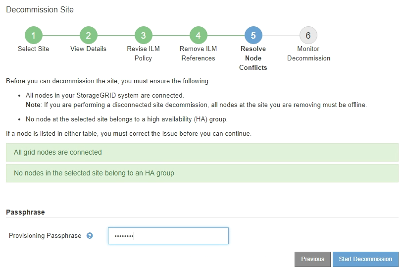

  1. Review the disconnected nodes section of Step 5 (Resolve Node Conflicts) to determine if any nodes in your StorageGRID system have a Connection State of Unknown (Icon Alarm Blue Unknown) or Administratively Down (Icon Alarm Gray Administratively Down).
    Decommission Site Step 5 Resolve Node Conflicts
  2. If any nodes are disconnected, bring them back online.
    See the Node procedures. Contact technical support if you need assistance.
  3. When all disconnected nodes have been brought back online, review the HA groups section of Step 5 (Resolve Node Conflicts).
    This table lists any nodes at the selected site that belong to a high availability (HA) group.
    Decommission Site Step 5 HA Groups
  4. If any nodes are listed, do either of the following:
    • Edit each affected HA group to remove the node interface.
    • Remove an HA group that only includes nodes from this site. See the instructions for administering StorageGRID.
    If all nodes are connected and no nodes in the selected site are used in an HA group, the Provisioning Passphrase field is enabled.
  5. Enter the provisioning passphrase.
    The Start Decommission button becomes enabled.
    Decommission Site Step 5 Provision Passphrase
  6. If you are ready to start the site decommission procedure, select Start Decommission.

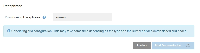

  7. Review the warning. If you are ready to begin, select OK.
    A message appears as the new grid configuration is generated. This process might take some time, depending on the type and number of decommissioned grid nodes.
    Decommission Site Step 5 Grid Configuration
    When the new grid configuration has been generated, Step 6 (Monitor Decommission) appears.
