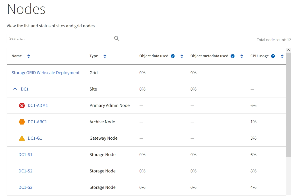

When you need more detailed information about your StorageGRID system than the dashboard provides, you can use the Nodes page to view metrics for the entire grid, each site in the grid, and each node at a site.
The Nodes table lists summary information for the entire grid, each site, and each node. If a node is disconnected or has an active alert, an icon appears next to the node name. If the node is connected and has no active alerts, no icon is shown.

Nodes Menu

Alert icons
If there is an active alert for a node, one of the following icons appears next to the node name:
Icon Alert Red Critical Critical: An abnormal condition exists that has stopped the normal operations of a StorageGRID node or service. You must address the underlying issue immediately. Service disruption and loss of data might result if the issue is not resolved.
Icon Alert Orange Major Major: An abnormal condition exists that is either affecting current operations or approaching the threshold for a critical alert. You should investigate major alerts and address any underlying issues to ensure that the abnormal condition does not stop the normal operation of a StorageGRID node or service.
Icon Alert Yellow Minor Minor: The system is operating normally, but an abnormal condition exists that could affect the system's ability to operate if it continues. You should monitor and resolve minor alerts that don't clear on their own to ensure they don't result in a more serious problem.
View details for a system, site, or node
To filter the information shown in the Nodes table, enter a search string in the Search field. You can search by system name, display name, or type (for example, enter gat to quickly locate all Gateway Nodes).
To view the information for the grid, site, or node:
  • Select the grid name to see an aggregate summary of the statistics for your entire StorageGRID system.
  • Select a specific data center site to see an aggregate summary of the statistics for all nodes at that site.
  • Select a specific node to view detailed information for that node.
