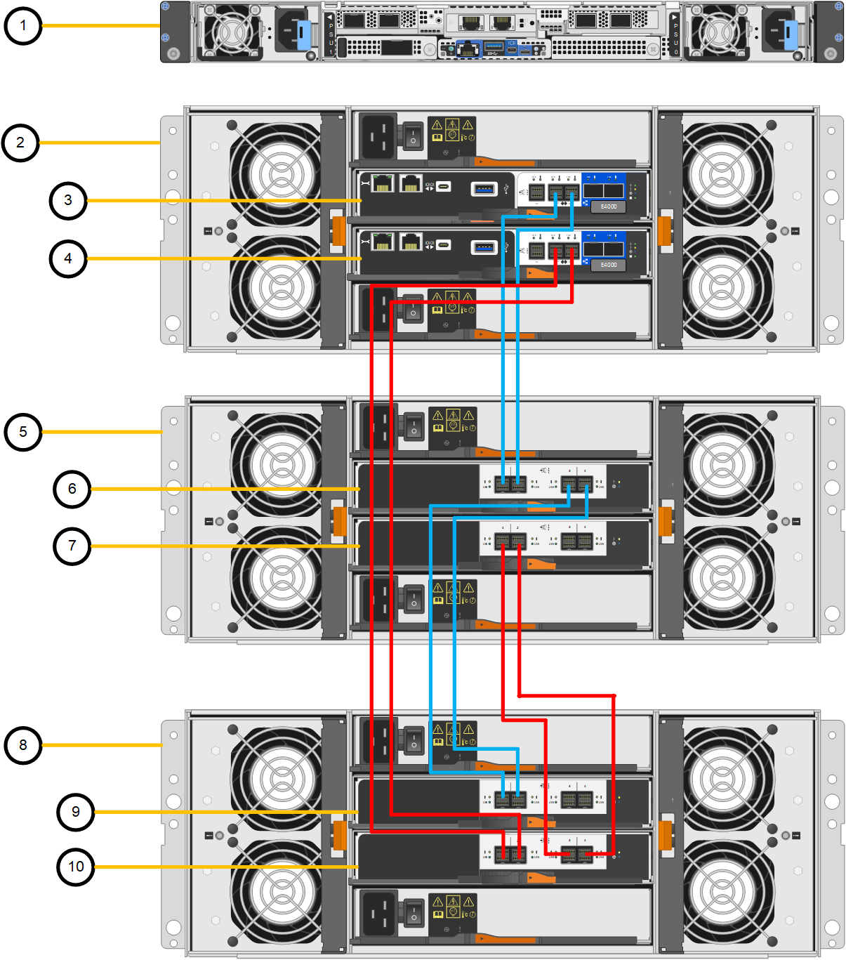

  3. Connect each expansion shelf to the E4000 controller shelf as shown in the diagram.
    This drawing shows two expansion shelves. If you have only one, connect IOM A to controller A and connect IOM B to controller B.
    SG6260 Expansion Shelf Connections
    Callout Description
    1
    SG6200-CN
    2
    3
    Controller A
    4
    Controller B
    5
    Expansion shelf 1
    6
    IOM A for expansion shelf 1
    7
    IOM B for expansion shelf 1
    8
    Expansion shelf 2
    9
    IOM A for expansion shelf 2
    10
    IOM B for expansion shelf 2
