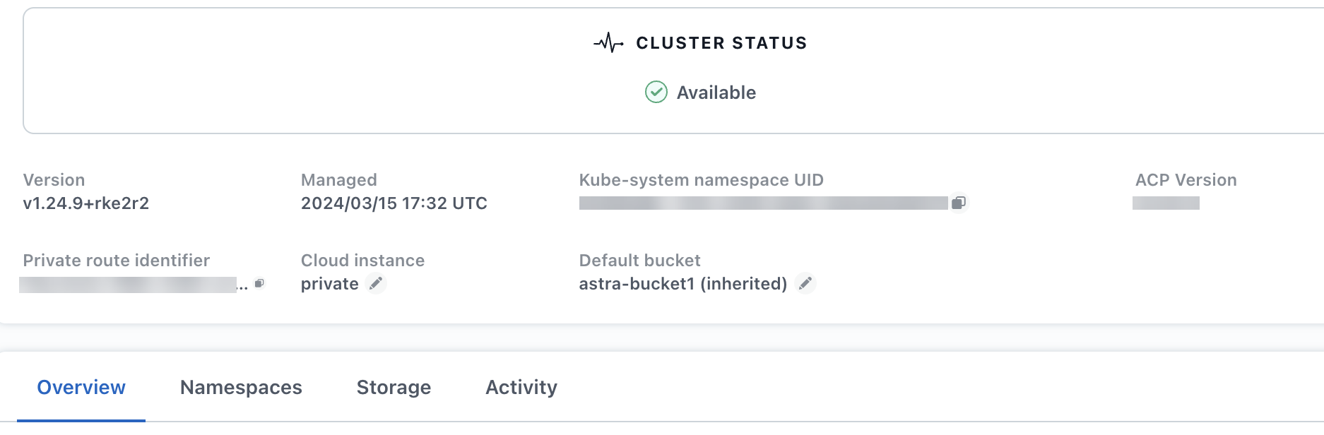

After Astra Control Provisioner is installed, the cluster hosting the provisioner in the Astra Control UI will show an ACP version rather than Trident version field and current installed version number.
