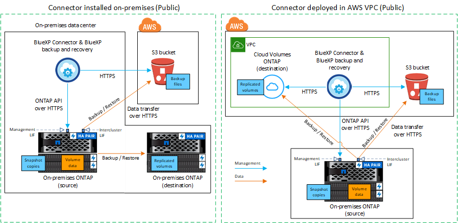

The following diagram shows the public connection method and the connections that you need to prepare between the components. You can use a Connector that you've installed on your premises, or a Connector that you've deployed in the AWS VPC.
A diagram showing how BlueXP backup and recovery communicates over a public connection with the volumes on the cluster and the AWS S3 storage where the backup files are located.

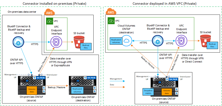

The following diagram shows the private connection method and the connections that you need to prepare between the components. You can use a Connector that you've installed on your premises, or a Connector that you've deployed in the AWS VPC.
A diagram showing how BlueXP backup and recovery communicates over a private connection with the volumes on the cluster and the AWS S3 storage where the backup files are located.

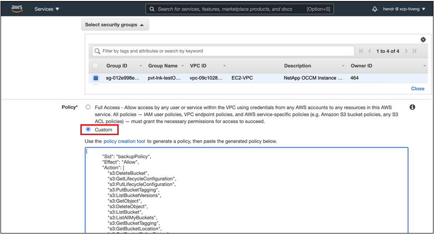

  2. Modify the security group configuration that's associated with the BlueXP Connector. You must change the policy to "Custom" (from "Full Access"), and you must add the S3 permissions from the backup policy as shown earlier.
    A screenshot of the AWS security group associated with the Connector.
    If you're using port 80 (HTTP) for communication to the private endpoint, you're all set. You can enable BlueXP backup and recovery on the cluster now.
    If you're using port 443 (HTTPS) for communication to the private endpoint, you must copy the certificate from the VPC S3 endpoint and add it to your ONTAP cluster, as shown in the next 4 steps.

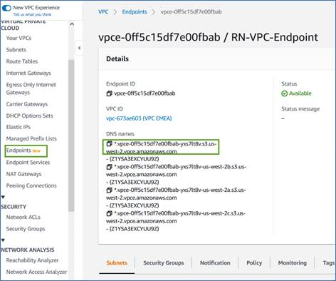

  3. Obtain the DNS name of the endpoint from the AWS Console.
    A screenshot of the DNS name of the VPC endpoint from the AWS Console.

    • Networking: Choose the IPspace, and whether you'll be using a Private Endpoint. Private Endpoint is disabled by default.
      1. The IPspace in the ONTAP cluster where the volumes you want to back up reside. The intercluster LIFs for this IPspace must have outbound internet access.
      2. Optionally, choose whether you'll use an AWS PrivateLink that you have previously configured. See details about using AWS PrivateLink for Amazon S3.
