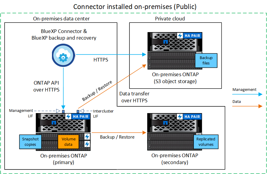

There are many configurations in which you can create backups to an S3 bucket on an ONTAP system. Two scenarios are shown below.
The following image shows each component when backing up a primary on-premises ONTAP system to an on-premises ONTAP system configured for S3 and the connections that you need to prepare between them. It also shows a connection to a secondary ONTAP system in the same on-premises location to replicate volumes.
A diagram showing how BlueXP backup and recovery communicates with the volumes on the source systems and the destination storage where the backup files are located.
When the Connector and primary on-premises ONTAP system are installed in an on-premises location without internet access (a "private" mode deployment), the ONTAP S3 system must be located in the same on-premises data center.

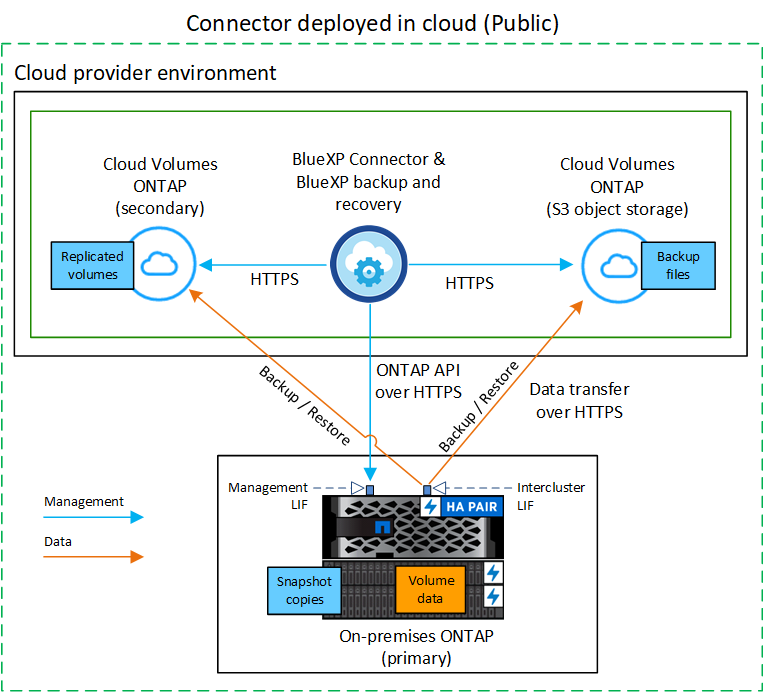

The following image shows each component when backing up a primary on-premises ONTAP system to a Cloud Volumes ONTAP system configured for S3 and the connections that you need to prepare between them. It also shows a connection to a secondary Cloud Volumes ONTAP system in the same cloud provider environment to replicate volumes.
In this scenario the Connector should be deployed in the same cloud provider environment in which the Cloud Volumes ONTAP systems are deployed.
