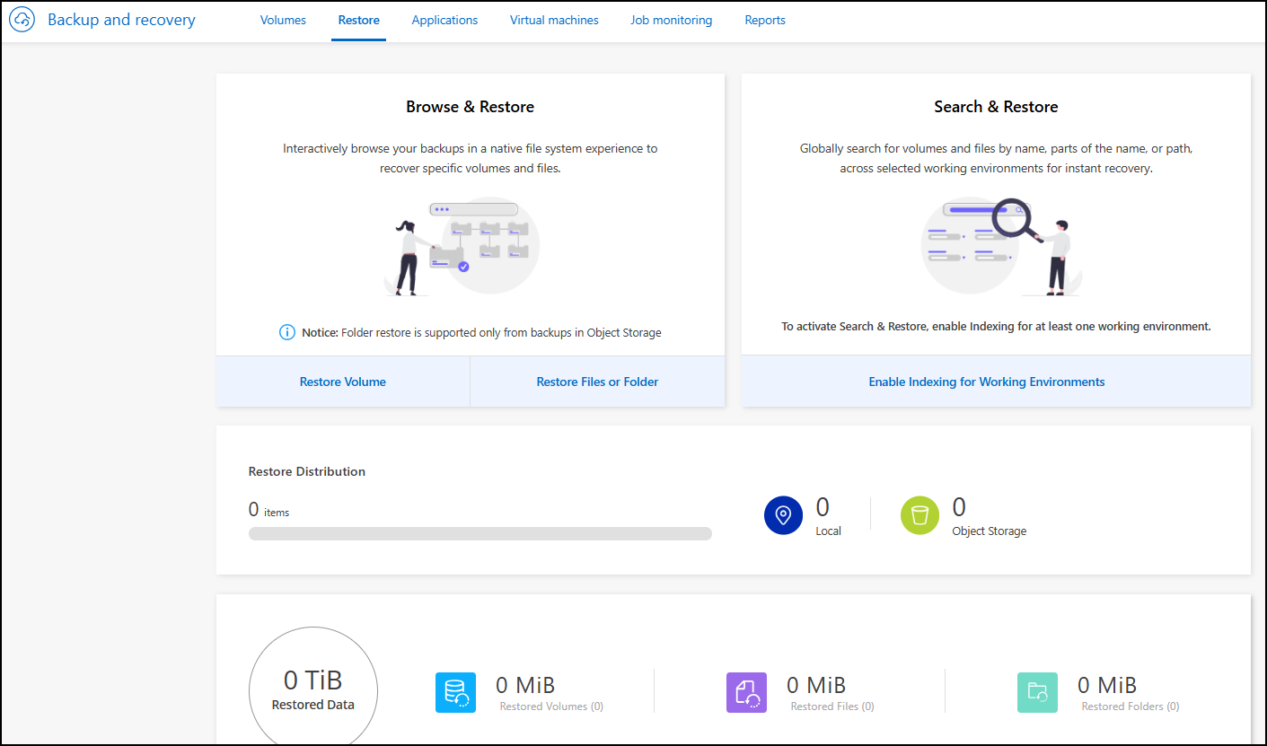

The Restore Dashboard
You use the Restore Dashboard to perform volume, folder, and file restore operations. You access the Restore Dashboard by clicking Backup and recovery from the BlueXP menu, and then clicking the Restore tab. You can also click More button > View Restore Dashboard from the Backup and recovery service from the Services panel.
Note BlueXP backup and recovery must already be activated for at least one working environment and initial backup files must exist.
The Restore Dashboard showing the options to use the Browse & Restore or Search & Restore functionality.

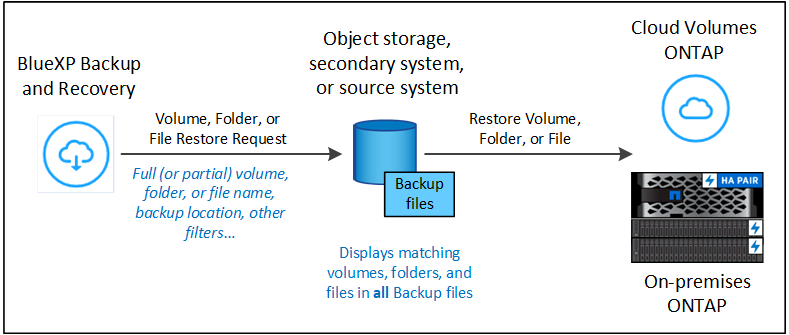

As you can see, the Restore Dashboard provides two different ways to restore data from backup files: Browse & Restore and Search & Restore.
Comparing Browse & Restore and Search & Restore
In broad terms, Browse & Restore is typically better when you need to restore a specific volume, folder, or file from the last week or month — and you know the name and location of the file, and the date when it was last in good shape. Search & Restore is typically better when you need to restore a volume, folder, or file, but you don't remember the exact name, or the volume in which it resides, or the date when it was last in good shape.

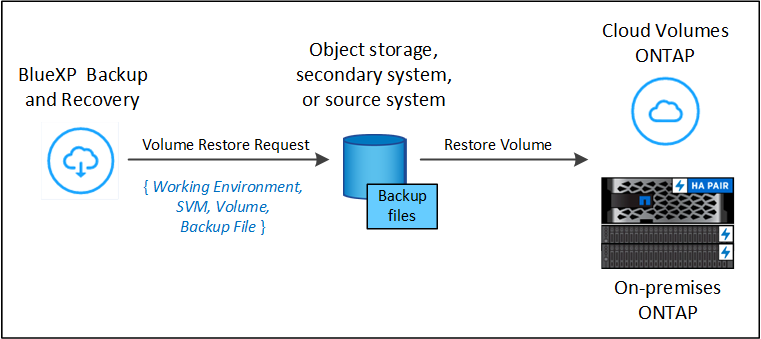

A diagram that shows the flow to perform a volume restore operation using Browse & Restore.
As you can see, you'll need to know the source working environment name, storage VM, volume name, and backup file date to perform a volume restore.

  1. From the BlueXP menu, select Protection > Backup and recovery.
  2. Select the Restore tab and the Restore Dashboard is displayed.
  3. From the Browse & Restore section, select Restore Volume.

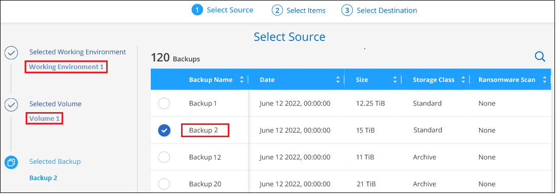

  4. In the Select Source page, navigate to the backup file for the volume you want to restore. Select the Working Environment, the Volume, and the Backup file that has the date/time stamp from which you want to restore.
    The Location column shows whether the backup file (Snapshot) is Local (a Snapshot copy on the source system), Secondary (a replicated volume on a secondary ONTAP system), or Object Storage (a backup file in object storage). Choose the file that you want to restore.
    A screenshot of selecting the working environment, volume, and volume backup file that you want to restore.
  5. Select Next.

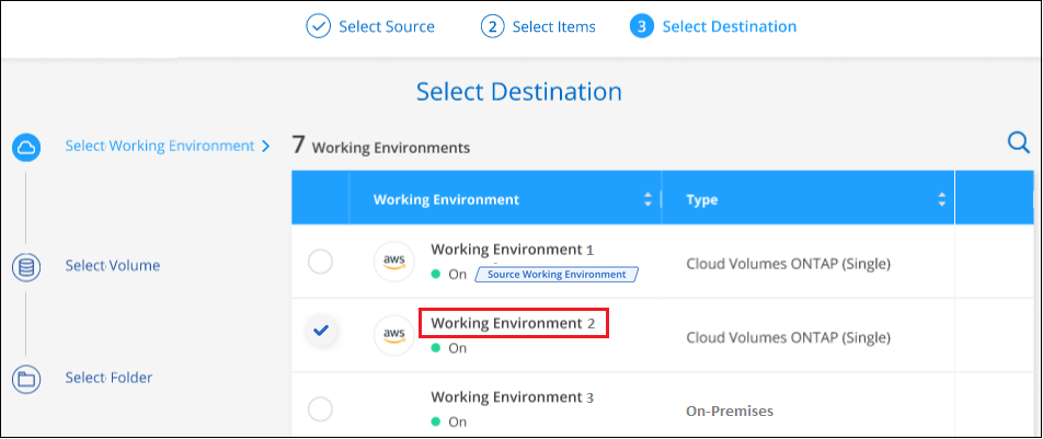

  6. In the Select Destination page, select the Working Environment where you want to restore the volume.
    A screenshot of selecting the destination working environment for the volume you want to restore.

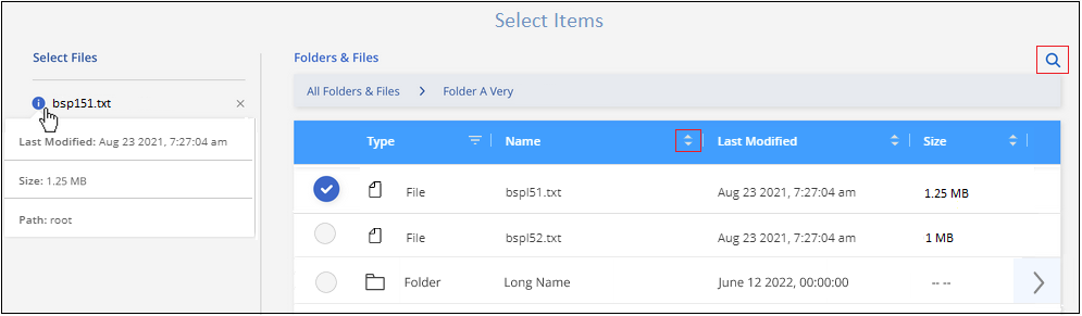

    A screenshot of the Select Items page so you can navigate to the items you want to restore.
  6. In the Select Items page, select the folder or file(s) that you want to restore and select Continue. To assist you in finding the item:
    • You can select the folder or file name if you see it.
    • You can select the search icon and enter the name of the folder or file to navigate directly to the item.
    • You can navigate down levels in folders using the Down arrow at the end of the row to find specific files.
      As you select files they are added to the left side of the page so you can see the files that you have already chosen. You can remove a file from this list if needed by selecting the x next to the file name.
  7. In the Select Destination page, select the Working Environment where you want to restore the items.
    A screenshot of selecting the destination working environment for the items you want to restore.
    If you select an on-premises cluster and you haven't already configured the cluster connection to the object storage, you are prompted for additional information:
    • When restoring from Azure Blob, enter the IPspace in the ONTAP cluster where the destination volume resides. You can also select a Private Endpoint Configuration for the connection to the cluster.
    • When restoring from StorageGRID, enter the FQDN of the StorageGRID server and the port that ONTAP should use for HTTPS communication with StorageGRID, enter the Access Key and Secret Key needed to access the object storage, and the IPspace in the ONTAP cluster where the destination volume resides.

Search & Restore process
The process goes like this:
  1. Before you can use Search & Restore, you need to enable "Indexing" on each source working environment from which you'll want to restore volume data. This allows the Indexed Catalog to track the backup files for every volume.
  2. When you want to restore a volume or files from a volume backup, under Search & Restore, select Search & Restore.
  3. Enter the search criteria for a volume, folder, or file by partial or full volume name, partial or full file name, backup location, size range, creation date range, other search filters, and select Search.
    The Search Results page displays all the locations that have a file or volume that matches your search criteria.
  4. Select View All Backups for the location you want to use to restore the volume or file, and then select Restore on the actual backup file you want to use.
  5. Select the location where you want the volume, folder, or file(s) to be restored and select Restore.
  6. The volume, folder, or file(s) are restored.
A diagram that shows the flow to perform a volume, folder, or file restore operation using Search & Restore.
As you can see, you really only need to know a partial name and BlueXP backup and recovery searches through all backup files that match your search.

Restore volumes, folders, and files using Search & Restore
After you have enabled Indexing for your working environment, you can restore volumes, folders, and files using Search & Restore. This allows you to use a broad range of filters to find the exact file or volume that you want to restore from all backup files.
Steps
  3. From the Search & Restore section, select Search & Restore.
  4. From the Search & Restore section, select Search & Restore.
