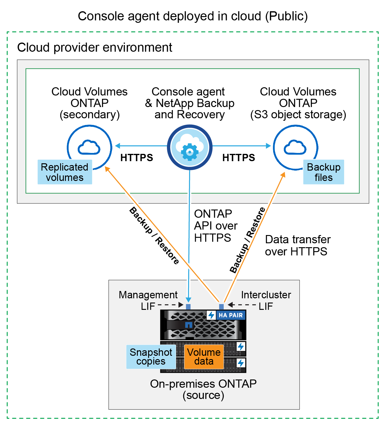

The following image shows each component when backing up a primary on-premises ONTAP system to a Cloud Volumes ONTAP system configured for S3 and the connections that you need to prepare between them. It also shows a connection to a secondary Cloud Volumes ONTAP system in the same cloud provider environment to replicate volumes.
A diagram showing how NetApp Backup and Recovery communicates with the volumes on the source systems and the destination storage where the backup files are located.
In this scenario, deploy the Console agent in the same cloud provider environment as the Cloud Volumes ONTAP systems.
