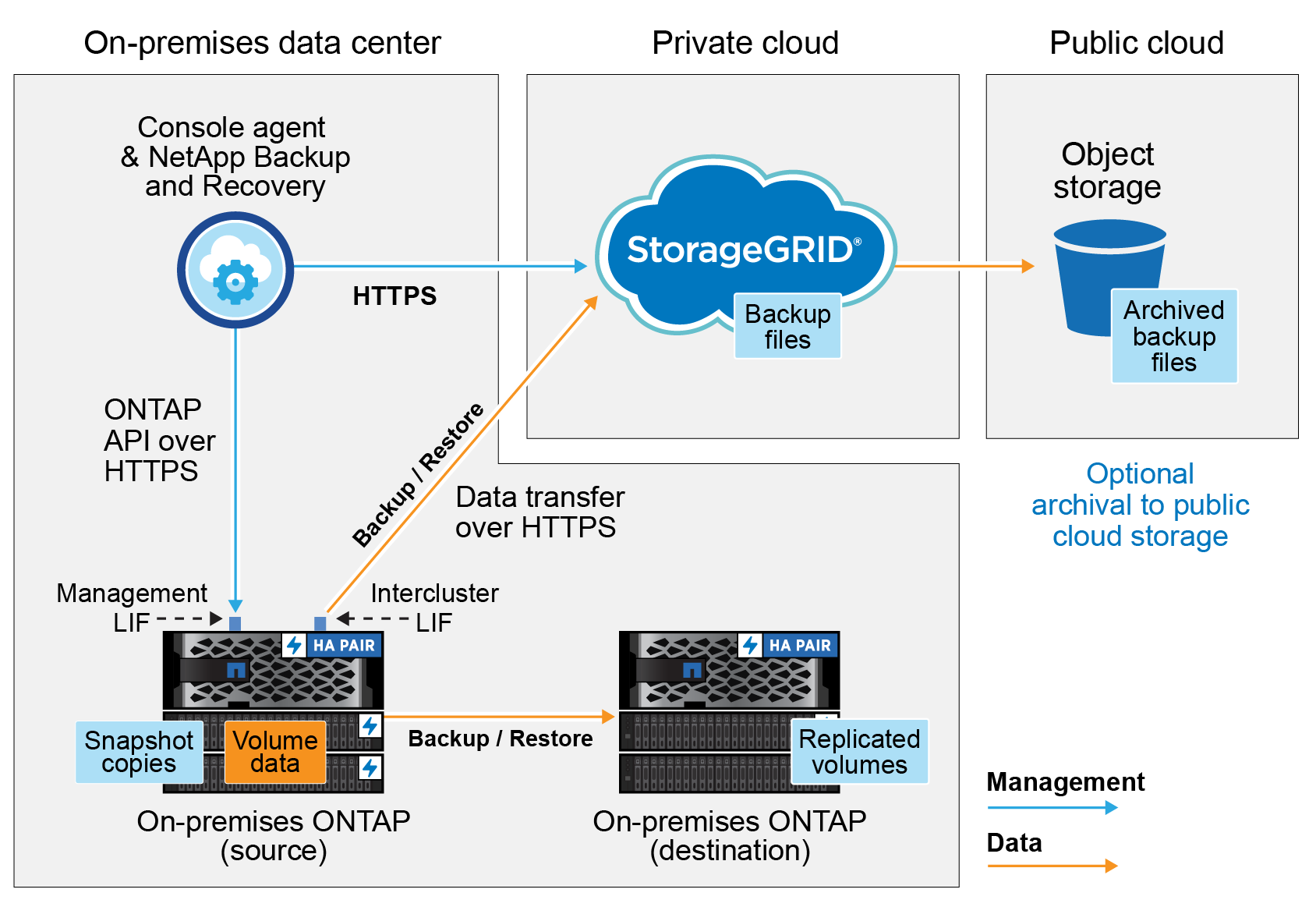

The following image shows each component when backing up an on-premises ONTAP system to StorageGRID and the connections that you need to prepare between them.
Optionally, you can connect to a secondary ONTAP system in the same on-premises location to replicate volumes.
A diagram showing how NetApp Backup and Recovery communicates with the volumes on the source systems and the destination storage where the backup files are located.
When the Console agent and on-premises ONTAP system are installed in an on-premises location without internet access (a "dark site"), the StorageGRID system must be located in the same on-premises data center. Archival of older backup files to public cloud is not supported in dark site configurations.

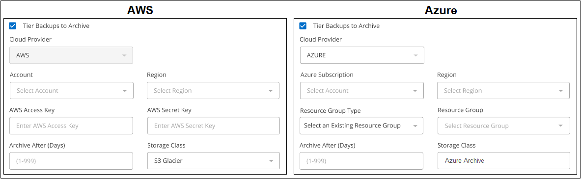

When defining the Archival settings for the backup policy for your cluster, you'll enter your cloud provider credentials and select the storage class that you want to use. NetApp Backup and Recovery creates the cloud bucket when you activate backup for the cluster. The information required for AWS and Azure archival storage is shown below.
A screenshot of the information you'll need to archive backup files from StorageGRID to AWS S3 or Azure Blob.
The archival policy settings you select will generate an information lifecycle management (ILM) policy in StorageGRID, and add the settings as "rules."
  • If there is an existing active ILM policy, new rules will be added to the ILM policy to move the data to the archive tier.
  • If there is an existing ILM policy in the "proposed" state, the creation and activation of a new ILM policy will not be possible. Learn more about StorageGRID ILM policies and rules.

    • Tier backup to public cloud: Select the cloud provider that you want to tier backups to and enter the provider details.
      Select or create a new StorageGRID cluster. For details about creating a StorageGRID cluster so the Console can discover it, refer to StorageGRID documentation.
