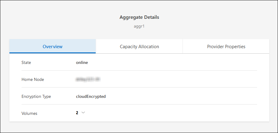

  1. On the Cloud Volumes ONTAP system, click the Aggregates tab.
  2. On the required aggregate tile, click the icon action icon, and then select View Aggregate details.
    Screen shot: Shows the State field when you view information for an aggregate.

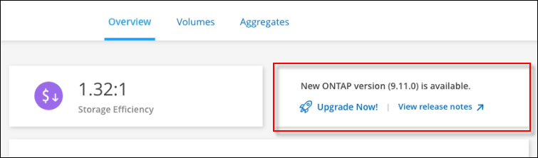

    A notification appears in the Overview tab if a new version is available:
    A screenshot that shows the "Upgrade now!" link under the Overview tab.

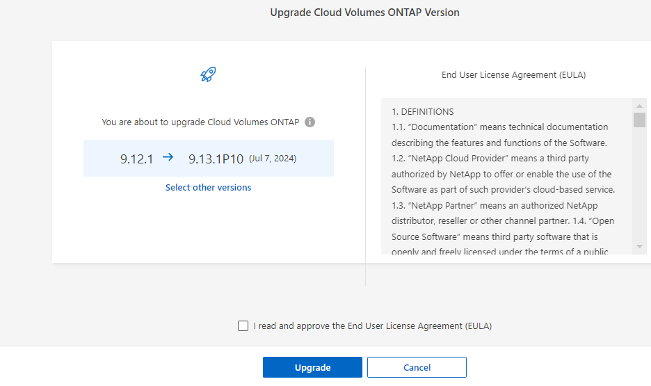

  3. If you want to upgrade the installed version of Cloud Volumes ONTAP, click Upgrade Now! By default, you see the latest, compatible version for upgrade.
    A screenshot of the Upgrade Cloud Volumes ONTAP version page.
    If you want to upgrade to another version, click Select other versions. You see the latest Cloud Volumes ONTAP versions listed that are also compatible with the installed version on your system.
    For example, the installed version on your system is 9.12.1P3, and the following compatible versions are available:
    • 9.12.1P4 to 9.12.1P14
    • 9.13.1 and 9.13.1P1
      You see 9.13.1P1 as the default version for upgrade, and 9.12.1P13, 9.13.1P14, 9.13.1, and 9.13.1P1 as the other available versions.
  4. Optionally, you can click All versions to enter another version that you want to upgrade to (say, the next patch of the installed version). For a compatible upgrade path of your current Cloud Volumes ONTAP version, refer to Supported upgrade paths.
  5. Click Save, and then Apply.
    A screenshot displaying the available versions for upgrade.
  6. In the Upgrade Cloud Volumes ONTAP page, read the EULA, and then select I read and approve the EULA.
  7. Select Upgrade.
