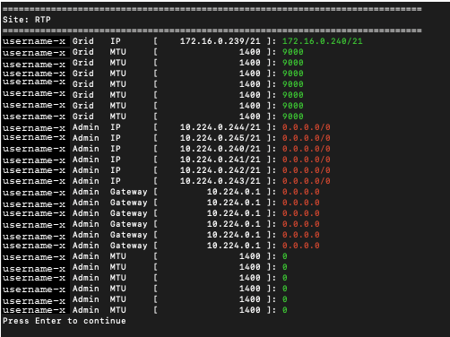

  7. Review your changes by selecting one of the following options:
    • 5: Shows edits in output that is isolated to show only the changed item. Changes are highlighted in green (additions) or red (deletions), as shown in the example output:
      screenshot described by surrounding text
    • 6: Shows edits in output that displays the full configuration. Changes are highlighted in green (additions) or red (deletions).
      Note Certain command line interfaces might show additions and deletions using strikethrough formatting. Proper display depends on your terminal client supporting the necessary VT100 escape sequences.

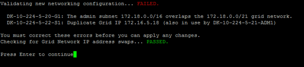

  8. Select option 7 to validate all changes.
    This validation ensures that the rules for the Grid, Admin, and Client Networks, such as not using overlapping subnets, aren't violated.
    In this example, validation returned errors.
    In this example, validation passed.
