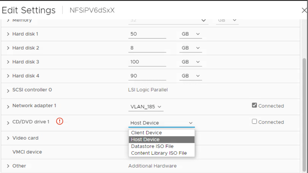

  1. Upload ONTAP tools for VMware vSphere upgrade ISO to content library.
  2. In the primary VM page, select Actions > Edit Settings. To identify the primary VM name:
    1. Enable diag shell on any node
    2. Run the following command: grep sourceHost /opt/netapp/meta/ansible_vars.yaml
  3. Select the content library ISO file in the edit settings window under the CD/DVD drive field.
  4. Select the ISO file and select OK. Choose the connected checkbox across the CD/DVD drive field. Edit settings
