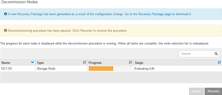

  3. Select Pause to suspend the procedure.
    The current stage is paused, and the Resume button is enabled.
    Decommission Nodes Procedure Paused
  4. After the other maintenance procedure is finished, select Resume to proceed with the decommission.
