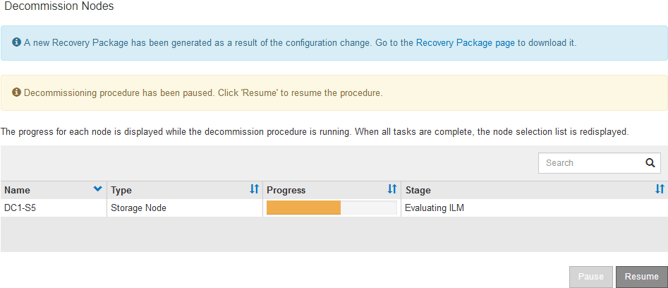

  3. Select Pause to suspend the procedure.
    The current stage is paused, and the Resume button is enabled.
    Decommission Nodes Procedure Paused
