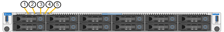

The following figure shows status indicators and buttons on the front of the SG100 and SG1000.
Front Indicators - SG1000
Callout Display State
1
Power button
  • Blue: the appliance is powered on.
  • Off: the appliance is powered off.
2
Reset button
Use this button to perform a hard reset of the controller.
3
Identify button
This button can be set to Blink, On (Solid), or Off.
  • Blue, blinking: Identifies the appliance in the cabinet or rack.
  • Blue, solid: Identifies the appliance in the cabinet or rack.
  • Off: The appliance is not visually identifiable in the cabinet or rack.
4
Alarm LED
  • Amber, solid: An error has occurred.
    Note: To view the boot-up and error codes, access the BMC interface.
  • Off: No errors are present.

SG110 and SG1100
The appliance includes indicators that help you determine the status of the appliance controller and the SSDs:
Appliance indicators and buttons
The following figure shows indicators and buttons on the front of the SG110 and SG1100 appliances.
Front Indicators - SG110 and SG1100
1
Power button
2
Reset button
3
Identify button
Using the BMC, this button can be set to blink, On (Solid), or Off.
4
Status LED
5
PFR
This light is not used by the SG110 and SG1100 appliances and remains off.

SG6100
Use this information to help troubleshoot SG6100 hardware installation.
The following figure shows indicators and buttons on the front of the SG6100 appliances.
Front Indicators - SGF6112
1
Power button
2
Reset button
3
Identify button
4
Status LED
5
PFR
This light is not used by SG6100 appliances and remains off.
