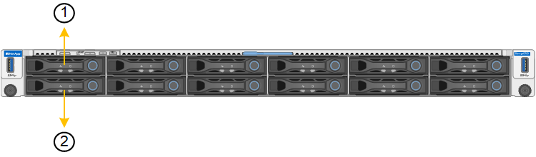

    3. Note the position of the replaceable components (two power supplies, seven cooling fans, three NICs, and two SSDs) in the failed appliance.
      The two drives are in the following positions in the chassis (front of chassis with bezel removed shown):
      Drive locations
      Drive
      1
      HDD00
      2
      HDD01
    4. Transfer the replaceable components to the replacement appliance.
      Follow the maintenance instructions provided for reinstalling the replaceable components.
      Caution If you wish to retain the data on the drives, insert the SSD drives into the same drive slots they occupied in the failed appliance. If you don't, the Appliance Installer will display a warning message and you will have to put the drives into the correct slots and reboot the appliance before the appliance can rejoin the grid.
