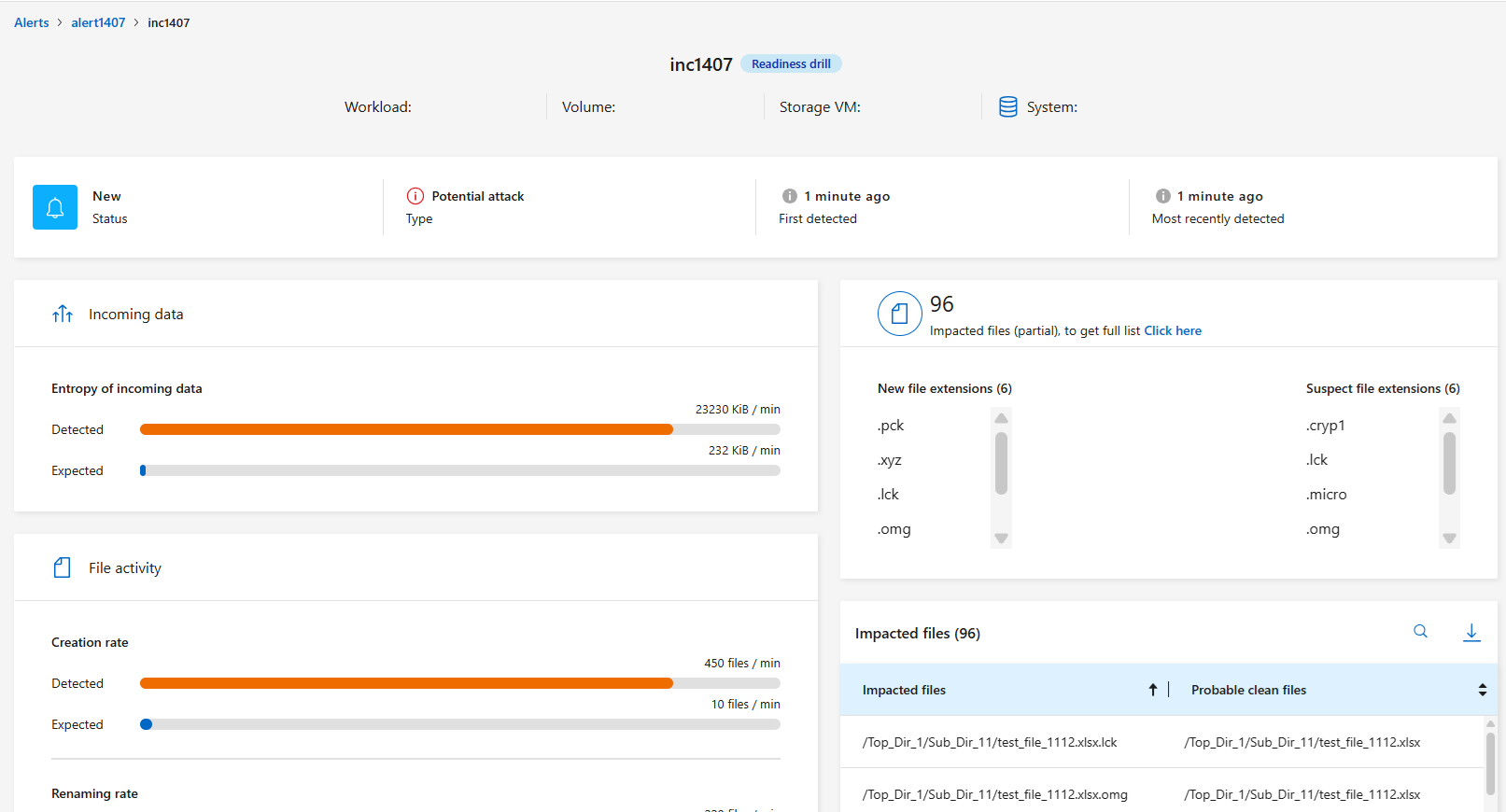

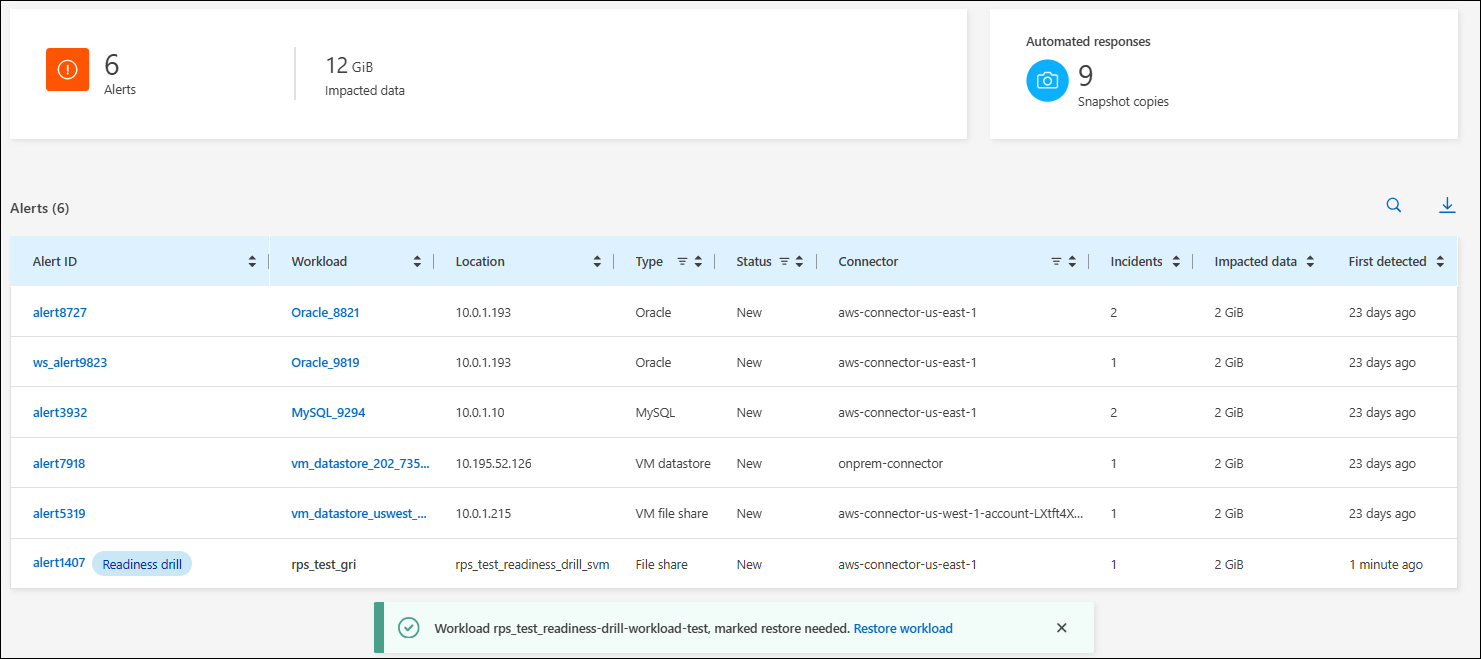

  1. From the Ransomware Resilience menu, select Alerts.
  2. Select the alert with the "Readiness drill" indication. A list of incident alerts appears on the Alerts details page.
    Alerts details page showing the readiness drill alert
  3. Review the alert incidents.
  4. Select an alert incident.
    Incident page showing the readiness drill alert
When reviewing the incident, consider:
  • The potential attack severity.
    If the severity indicates that a user is suspected of malicious activity, review the user name. You can also block the user.
  • Review the file activity and suspected processes:
    • Look at the incoming detected data compared to the expected data.
    • Look at the creation rate of files that is detected compared to the expected rate.
    • Look at the file renaming rate that is detected compared to the expected rate.
    • Look at the deletion rate compared to the expected rate.
  • Look at the list of impacted files. Look at the extensions that might be causing the attack.
  • Determine the impact and breadth of the attack by reviewing the number of impacted files and directories.

  1. Return to the Alert details page.
  2. If the test workload should be restored, select Mark restore needed then select that button again in the confirmation dialog.
  3. From the Ransomware Resilience menu, select Recovery.
  4. Select the test workload marked with the "Readiness drill" tag that you want to restore.
  5. Select Restore.
