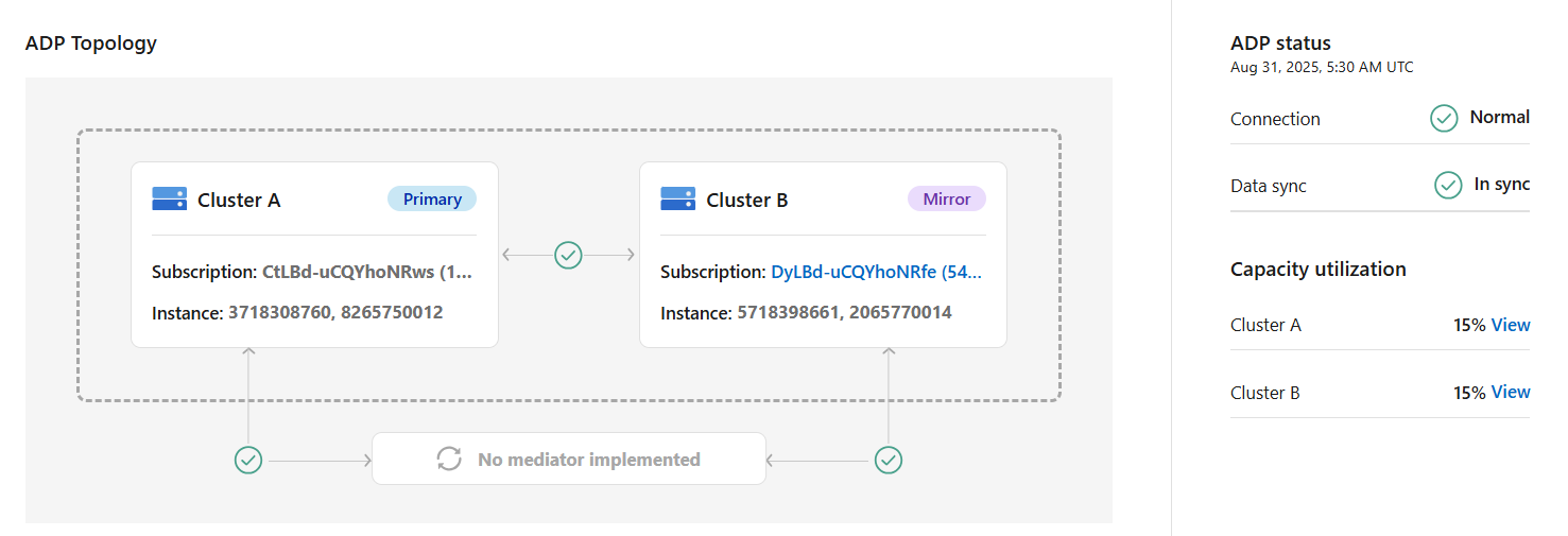

    • Monitor the health status of your MetroCluster setup in the ADP Topology view.
      The topology displays the connection status between the primary and mirror sites (normal, degraded, disconnected, or initializing), the data synchronization status (in sync or out of sync), and the ONTAP Mediator status if configured. To learn more about ONTAP Mediator, refer to Learn about ONTAP Mediator.
      Image of ADP topology displaying primary site (Cluster A)
      Tip You can select the Cluster B subscription (mirror) from the ADP topology to view it as the primary site.
      Tip If the sync status shows out of sync or the connection status shows degraded, refer to Support services for Keystone to troubleshoot the issue.
