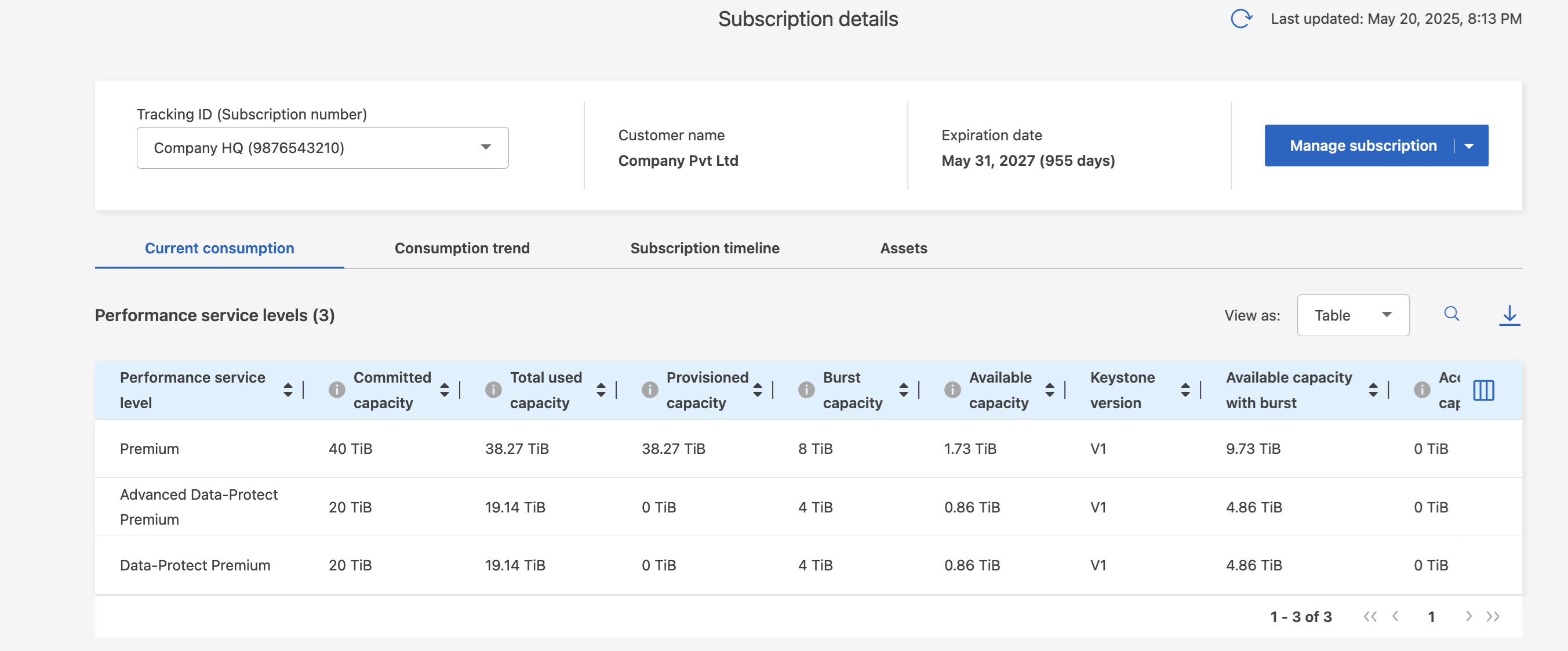

    current consumption details in the graphical format
    For the selected subscription, you can view consumption details in either table or graphical format using the Table or Graph option from the View as dropdown. In the graphical view, you can see the current consumption per performance service level, including used capacity, provisioned capacity, committed capacity limit, and burst capacity limit.
    In the table view, you can see details like maximum capacity consumed and days remaining until expiration. As part of monitoring your subscription usage, you can view the performance service level name, capacity usage, committed and used capacities, provisioned and burst capacities, available capacity, and volumes. You can customize the table using the column selector column selector icon icon.
    current consumption details in the table format
    Note If you have subscribed to add-on services such as advanced data protection (ADP) or Data Infrastructure Insights (DII), the current consumption for these services appears alongside your base performance service levels in both graphical and table views. To learn more about add-on services, refer to Learn about add-on services.

    Current Consumption tab
    For the selected subscription, you can view details, such as the start and end dates of the subscription, and the billing period, such as monthly or annual. As a part of the subscription usage, you can view the performance service level name, committed, consumed, available capacities, and current and accrued burst usage (in TiB). Specific performance service levels that record higher consumption are highlighted. You can also view warnings and alerts generated for your volumes.
    Coupled with the current consumption, you might want to view the historical usage data for comparison. Click the View Historical Data button to navigate to the Consumption Trend tab to view the historical data for the same subscription.
