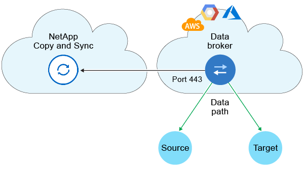

Data broker in the cloud
The following image shows a data broker running in the cloud, in either AWS, Google Cloud, or Azure. The source and target can be in any location, as long as there's a connection to the data broker. For example, you might have a VPN connection from your data center to your cloud provider.
When BlueXP copy and sync deploys the data broker in AWS, Azure, or Google Cloud, it creates a security group that enables the required outbound communication. |
