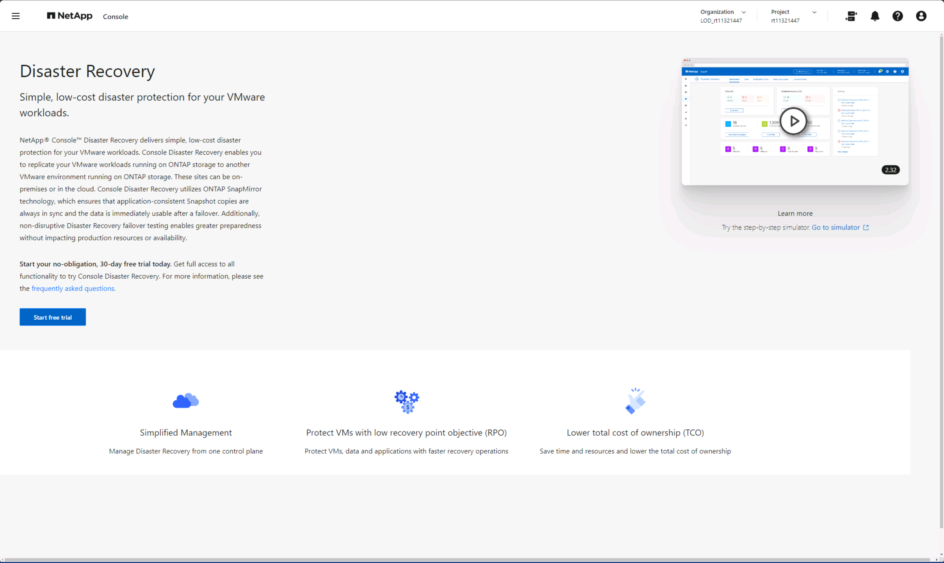

    If this is your first time logging in to this service, the landing page appears.
    Landing page screenshot for BlueXP disaster recovery

  5. After you set up a Connector, in the BlueXP disaster recovery landing page, the button to add a Connector changes to a button for starting a free trial. Select Start free trial.
