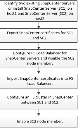

Configure high availability using F5
The workflow image lists the steps to configure SnapCenter Servers for high availability using F5 load balancer. For detailed instruction, refer to How to configure SnapCenter Servers for high availability using F5 Load Balancer.
HA configuration using F5
