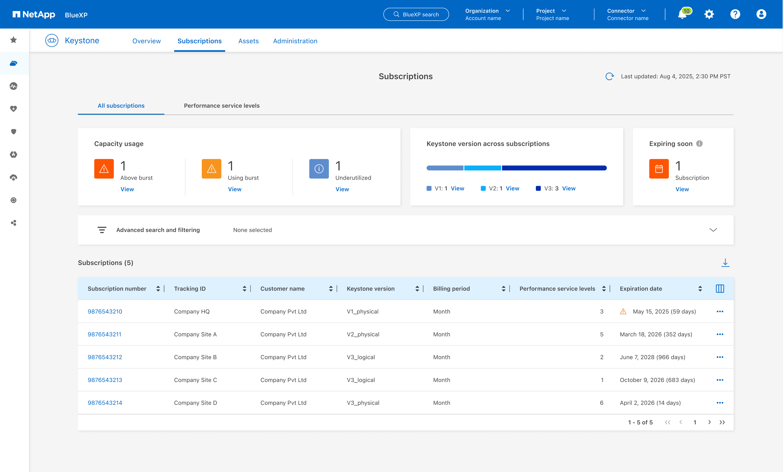

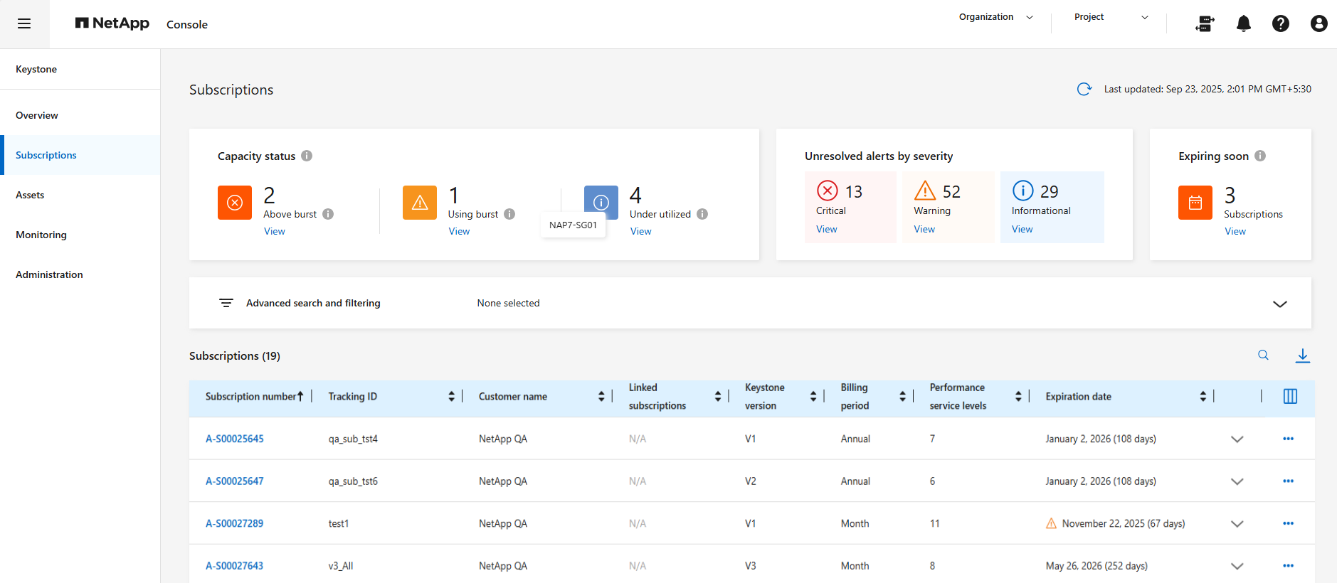

  1. From the Console left navigation menu, select Storage > Keystone > Subscriptions.
    view the subscription tab details
    You see the key metrics such as capacity usage, subscription expiry status, and unresolved alerts.
    You can see the following details from the table:
    • Subscription number: The subscription number of the Keystone subscription assigned by NetApp. Subscriptions with the MetroCluster subscription symbol icon are MetroCluster subscriptions. To learn more about MetroCluster subscriptions, refer to View consumption and health of your Keystone MetroCluster subscriptions.
    • Tracking ID: The tracking ID assigned at the time of subscription activation. This is a unique ID for each subscription and site, used for tracking the subscription.
    • Customer name: The name of the customer associated with the Keystone subscription.
    • Linked subscriptions: If you have any secondary subscriptions linked to your primary subscription, this column lists the linked subscription numbers for the primary subscription. This column is hidden by default and is visible only when linked subscriptions are available.
    • Keystone version: The version of the Keystone service that is being used for the subscription. The rate plan rules for performance service levels may differ between subscription versions. To learn more about version v1, refer to Keystone subscription services | Version 1 documentation. This column is hidden by default and can be enabled using the column selector column selector icon icon.
    • Usage type: You might have subscribed to multiple Keystone versions. The rate plan rules for performance service levels may differ between subscription versions. By looking at the value in this column, you know whether the usage type is billed as per the provisioned, physical, or logical usage. To learn more about version 1, refer to Keystone subscription services | Version 1 documentation.
    • Billing period: The invoicing period of the subscription.
    • Performance service levels: The number of rate plans associated with the subscription, with each rate plan corresponding to a specific performance service level and committed capacity.
    • Highest capacity: The maximum capacity consumed within the subscription.
    • Days to subscription expiry: Displays an icon alongside the expiration date to indicate how close the subscription is to expiring and whether it will renew automatically. This status is read-only and reflects your contract terms. To review contract details, refer to View the timeline of your Keystone subscriptions.
      When auto-renewal is off, the icon color indicates expiry proximity:
      • Green: More than 120 days remain until expiry.
      • Orange: Between 91 and 120 days remain until expiry.
      • Red: Fewer than 90 days remain until expiry. To avoid service disruption, submit a renewal request to NetApp Keystone support.
      • Gray: The subscription has expired.
        For subscriptions with auto-renewal on, an auto-renewal icon is displayed, indicating the subscription will renew automatically at the end of the current term.
        Note You can click the down arrow expand icon in the table header to expand all subscriptions and view the performance service levels information for each subscription simultaneously. This shows detailed capacity information including current usage, committed capacity, provisioned capacity, burst capacity, and available capacity for all subscriptions. Alternatively, you can click the down arrow next to the Expiration date column in individual subscription rows to expand them one at a time.
        Tip You can customize the columns displayed in the table using the column selector column selector icon icon. For certain fields and columns, you might see information or warning icons and tooltips that provide you with additional information about the data.

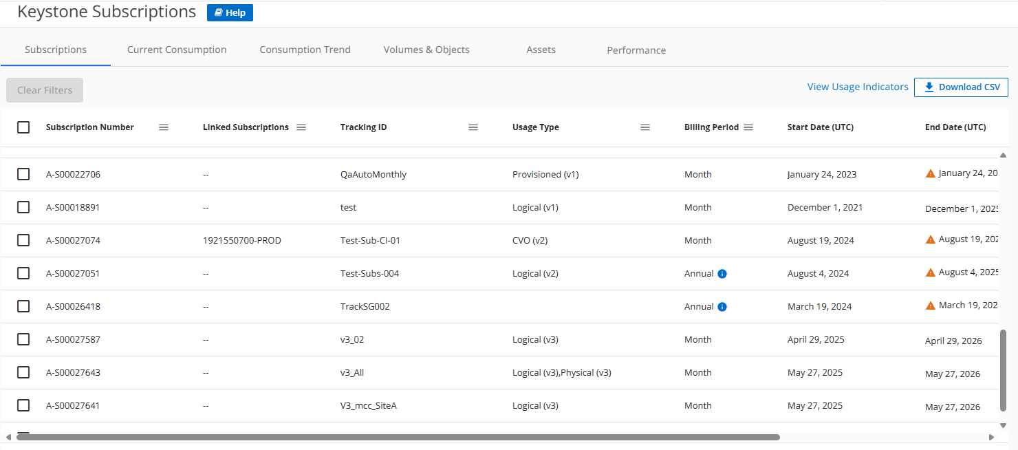

  1. From the Digital Advisor left navigation pane, go to General > Keystone Subscriptions > Subscriptions.
    You can view all your subscriptions here, with detailed insights for each one.
    an image of the Subscriptions tab
    • Subscription Number: The subscription number of the Keystone subscription assigned by NetApp.
    • Linked Subscriptions: If you have any secondary subscriptions linked to your primary subscription, this column lists the linked subscription numbers for the primary subscription.
    • Tracking ID: The tracking ID assigned at the time of subscription activation. This is a unique ID for each subscription and site.
    • Usage Type: You might have subscribed to multiple Keystone versions. The rate plan rules for performance service levels may differ between subscription versions. By looking at the value in this column, you know whether the usage type is billed as per the provisioned, physical, or logical usage. To learn more about version 1, refer to Keystone subscription services | Version 1 documentation.
    • Billing Period: The invoicing period of the subscription.
    • Start Date: The start date of the subscription.
    • End Date: The end date of the subscription. If you have a monthly-billable subscription that renews automatically every month, you see Month-on-month instead of the end date. Based on this date, you might see notifications for subscriptions that are about to end or have auto-renewal policies attached.
    • Usage Status: Displays the usage indicator to indicate whether the consumption is within or exceeding the subscription limit. You can sort the list by this column if you want to view the highest consumption records.
    • icon: Clicking this icon for a subscription opens the Current Consumption tab with the usage details of that subscription.
    • icon: Clicking this icon opens the Consumption Trend tab where you can see the historical usage data for each performance service level included in this subscription.
      You can refer to the usage indicators to check the usage status of each subscription:
      grey dot icon No consumption: No capacity usage recorded against the committed capacity of the performance service level.
      green dot icon Normal: The consumption is normal.
      amber dot icon High: Maximum consumption, that is the usage is about to reach 100% or more of the committed capacity.
      red dot icon Burst: The consumption is within the burst limit. The burst consumption is the consumption that tops the 100% committed capacity of a performance service level, and is within the agreed-upon burst usage limit.
      purple dot icon Above burst limit: Indicates consumption above the agreed-upon burst limit.
