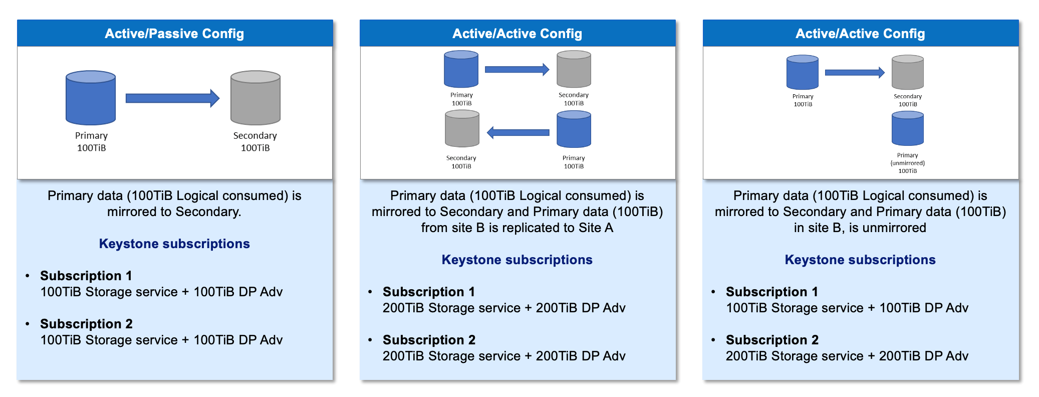

Supported MetroCluster configurations
Keystone supports the following MetroCluster deployment scenarios:
Active/Passive configuration
In this configuration, primary data at one site is mirrored to a secondary site. For example, if 100 TiB of logical data is consumed at site A, it is replicated to site B. Both sites require identical subscriptions:
  • Subscription 1 (site A): 100 TiB storage service + 100 TiB ADP
  • Subscription 2 (site B): 100 TiB storage service + 100 TiB ADP
Active/Active configuration with full mirroring
In this configuration, both sites host primary data that is mirrored bidirectionally. For example, 100 TiB of primary data at site A is mirrored to site B, and 100 TiB of primary data at site B is mirrored to site A. Both sites require subscriptions for the combined capacity:
  • Subscription 1 (site A): 200 TiB storage service + 200 TiB ADP
  • Subscription 2 (site B): 200 TiB storage service + 200 TiB ADP
Active/Active configuration with partial mirroring
In this configuration, one site hosts mirrored data while the other site hosts both mirrored and unmirrored data. For example, 100 TiB of primary data at site A is mirrored to site B, while site B also hosts an additional 100 TiB of unmirrored data. The subscriptions differ based on the capacity at each site:
The following diagram shows these supported MetroCluster configurations:
Diagram showing three MetroCluster configurations: Active/Passive with symmetric mirroring
