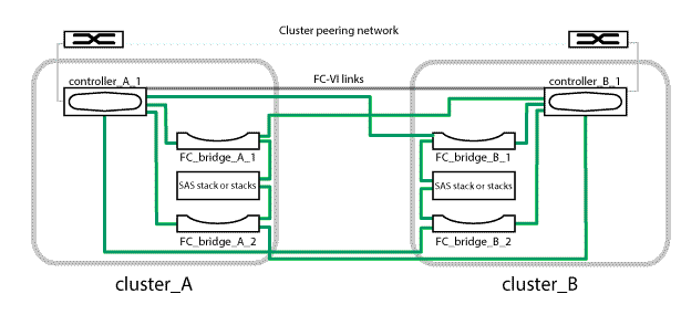

  3. Cable each bridge to the controller FC ports:
    1. Cable FC port 1 of the bridge to an FC port on the controller in cluster_A.
    2. Cable FC port 2 of the bridge to an FC port on the controller in cluster_B.
      • If the controller is configured with a quad-port FC adapter, make sure that the bridges at either end of the storage stack are not connected to two FC ports on the same ASIC. For example:
        • Port a and port b share the same ASIC.
        • Port c and port d share the same ASIC.
          In this example, connect FC_bridge_A_1 to port a and FC_bridge_A2 to port c.
      • If the controller is configured with more than one FC adapter, do not cable the bridges at either end of the storage stack to the same adapter.
        In this scenario, you should connect FC_bridge_A_1 to an onboard FC port, and connect FC_bridge_A_2 to an FC port on an adapter in an expansion slot.
        Illustration of a cluster peering network
  4. Repeat Step 3 on the other bridges until all of the bridges have been cabled.
