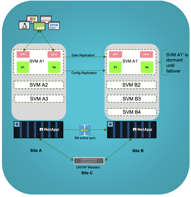

SnapMirror active sync operation workflow for NAS configurations
Beginning with ONTAP 9.19.1, SnapMirror active sync provides protection for NAS workloads at the SVM level. In a NAS configuration, the destination (secondary) SVM remains in a dormant state until a failover event occurs. To enable non-disruptive failover, the network identity and protocol configurations, including IP addresses, must be identical on both the primary and secondary SVMs. These configurations are automatically replicated to the secondary cluster, ensuring consistent IP addressing and protocol settings across both clusters. The following figure illustrates the design of SnapMirror active sync in a NAS configuration at a high level.
SnapMIrror active sync NAS configuration
In ONTAP 9.19.1, only FlexVol volumes are supported. Consistency groups are not supported. With FlexVol only support, the secondary cluster does not guarantee write-order-consistency across volumes. In the figure, data and configuration information is replicated from SVM A1 on the source cluster to the dormant SVM, SVM A1', on the destination cluster.
